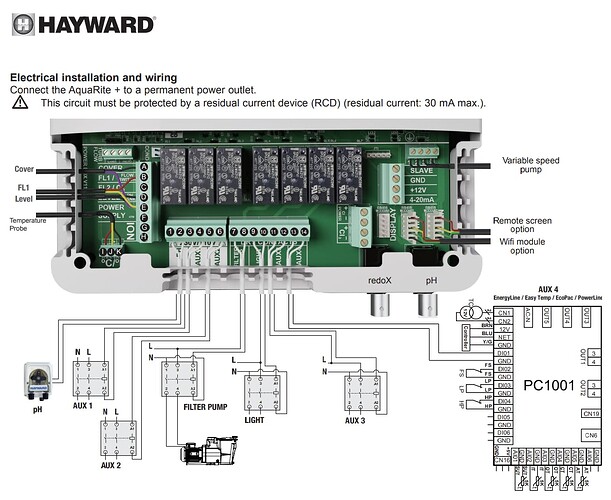

I can’t find a wiring schema. I know it’s simple, but my chlorinator (Hayward), doesn’t show a map for the RS485 pins for the wifi addon (I guess that’s were this should be pluged in, right?).
This is my board schema from Hayward docs:
and this is the RS485 section zoomed in:
If I understood right, I have to connect into the RS485 labeled as “Wifi module option”, right? Thing is I can’t find map pins for this connector.
This is a pic taken from my board itself:
Can anyone help me out about pin order? Also Tail485 labeling doesn’t seem too easy for me. I’ve developed a couple of RS485 integrations before, but no can’t figure how the ping go here.
I’m using an Atom Lite + Tail485.
Thanks! :slight_smile:

Thank you @alexdelprete didn’t know that info was at the Tasmota website. All the process was quite straight forward and I got it working with this final help.
