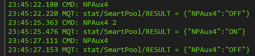

Did the procedure and activated persistent Berry commands.
Now i see fully the tasmota button, but clicking on it do not change the state, nor works from HA neopool dashboard…what am i doing wrong ?
Also tried to launch some userdefined command after, from the consol, such as NPVersion and they return correct info . But as you could see below, if i toggle one AUX with NPaux4 it shows it toggles, but the status do not change
unfortunately you tested it with the worse case (still on some Sugar Valley Aux4 not working), is AUX1 working?
And can you tell what Sugar Valley system you have (model and version)?
14:42:21.376 MQT: stat/SmartPool/RESULT = {"NPAux2":"ON"} 14:42:25.909 MQT: tele/SmartPool/SENSOR = {"Time":"2025-02-08T14:42:25","NeoPool":{"Time":"2025-02-08T14:42:24","Type":"Oxilife","Modules":{"pH":1,"Redox":0,"Hydrolysis":1,"Chlorine":0,"Conductivity":0,"Ionization":0},"Temperature":6.8,"Powerunit":{"Version":"V4.3","NodeID":"XXXX XXXX XXXX XXXX XXXX 3631","5V":5,"12V":12,"24-30V":33,"4-20mA":0.040},"pH":{"Data":7.2,"Min":7.0,"Max":7.2,"State":0,"Pump":0,"FL1":0,"Tank":1},"Hydrolysis":{"Data":0,"Unit":"%","Setpoint":30,"Max":100,"Percent":{"Data":0,"Setpoint":30},"Runtime":{"Total":"69T00:10:09","Part":"69T00:10:09","Pol1":"34T12:43:13","Pol2":"34T11:26:56","Changes":281},"State":"Pol2","Cover":0,"Boost":0,"Low":0,"FL1":0,"Redox":0},"Filtration":{"State":0,"Speed":1,"Mode":3},"Light":0,"Relay":{"State":[0,0,0,1,0,0,0],"Aux":[1,0,0,0],"Acid":0},"Connection":{"Time":"2025-02-07T23:35:52","MBRequests":207215,"MBNoError":204278,"MBIllegalFunc":0,"MBIllegalDataAddr":0,"MBIllegalDataValue":0,"MBSlaveError":0,"MBAck":0,"MBSlaveBusy":0,"MBNotEnoughData":0,"MBMemParityErr":0,"MBCRCErr":0,"MBGWPath":0,"MBGWTarget":0,"MBRegErr":0,"MBRegData":0,"MBTooManyReg":0,"MBUnknownErr":0,"MBNoResponse":2937,"DataOutOfRange":0}}} (retained) 14:42:27.911 MQT: tele/SmartPool/SENSOR = {"Time":"2025-02-08T14:42:27","NeoPool":{"Time":"2025-02-08T14:42:26","Type":"Oxilife","Modules":{"pH":1,"Redox":0,"Hydrolysis":1,"Chlorine":0,"Conductivity":0,"Ionization":0},"Temperature":6.8,"Powerunit":{"Version":"V4.3","NodeID":"XXXX XXXX XXXX XXXX XXXX 3631","5V":5,"12V":14,"24-30V":33,"4-20mA":0.050},"pH":{"Data":7.2,"Min":7.0,"Max":7.2,"State":0,"Pump":0,"FL1":0,"Tank":1},"Hydrolysis":{"Data":0,"Unit":"%","Setpoint":30,"Max":100,"Percent":{"Data":0,"Setpoint":30},"Runtime":{"Total":"69T00:10:09","Part":"69T00:10:09","Pol1":"34T12:43:13","Pol2":"34T11:26:56","Changes":281},"State":"Flow","Cover":0,"Boost":0,"Low":0,"FL1":1,"Redox":0},"Filtration":{"State":0,"Speed":1,"Mode":3},"Light":0,"Relay":{"State":[0,0,0,0,0,0,0],"Aux":[0,0,0,0],"Acid":0},"Connection":{"Time":"2025-02-07T23:35:52","MBRequests":207223,"MBNoError":204286,"MBIllegalFunc":0,"MBIllegalDataAddr":0,"MBIllegalDataValue":0,"MBSlaveError":0,"MBAck":0,"MBSlaveBusy":0,"MBNotEnoughData":0,"MBMemParityErr":0,"MBCRCErr":0,"MBGWPath":0,"MBGWTarget":0,"MBRegErr":0,"MBRegData":0,"MBTooManyReg":0,"MBUnknownErr":0,"MBNoResponse":2937,"DataOutOfRange":0}}} (retained) 14:42:48.771 MQT: stat/SmartPool/RESULT = {"NPFiltration":"OFF","Speed":"1"} 14:42:48.798 MQT: stat/SmartPool/RESULT = {"NPFiltrationmode":"Smart"} 14:42:51.446 MQT: stat/SmartPool/RESULT = {"NPAux":"Error"}
This is what I got, apparently blinks on for a while, but also switch on my pump and the gives error and switches off.
Sorry, but can you pls simply tell me which Model Number of the Oxilfie you have?
The issue (AUX not switching) you have has nothing to do with HA or this integration via MQTT so you have to set up all tests using commands NPAux1 on Tasmota Console without using HA or this integration.
Again: Is NPAux1 ON/NPAux1 OFF switches Aux1 on your system? You have to test this with Aux1, not with Aux2 and not with Aux3 and not with Aux4.
Also tell me which Aux do you are using for which function (you can use Tasmota cmnd NPControl to get these information).
Oxilife ox1
I sent you the log to show that aux2 toggle for a sec, but as result also toggle filtration on for a sec only.
The aux 1 is for the UV lamp and it’s automated with flow. Tried to manual toggle on but no success. It won’t toggle.
I think we are only making slow progress here:
If I write that you should use NPAux(x) ON (1) and OFF (0) (and not 2 for toggle), there are also certain reasons for this. Toggle (2) works differently than ON (1)/OFF (0). I would also like to know whether the relay switches physically, no log tells me that.
What does NPControl provide?
To make some progress here, I would like to ask you to carry out the following steps exactly as described here.
We already know that your AUX are not working as they should. To analyze the problem, you should do the following on the Tasmota WebUI under “Tools/Console” (without own modification)
  1. Please share what NPControl delivers, e. g.
11:01:38.646 CMD: NPControl
11:01:38.653 RSL: NPCONTROL = {"Modules":{"pH":1,"Redox":1,"Hydrolysis":1,"Chlorine":0,"Conductivity":0,"Ionization":0},"Relay":{"Acid":1,"Base":0,"Redox":0,"Chlorine":0,"Conductivity":0,"Heating":0,"UV":0,"Valve":0}}
  1. Prepare the follwoing for step 3 to 6
    To exclude all side effects, we disable temporarly MQTT on Tasmota with command SO3 0 and switch filtration mode to manual:
10:58:09.965 CMD: NPFiltrationmode Manual
10:58:09.968 MQT: stat/SmartPool/NPFILTRATIONMODE = {"NPFiltrationmode":"Manual"}
10:58:11.965 CMD: SO3 0
10:58:11.968 RSL: SO = {"SetOption3":"OFF"}
The system reboots.
  1. Now get the current status auf Aux
11:03:29.534 CMD: NPAux1
11:03:29.629 RSL: NPAUX = {"NPAux1":"OFF"}
  1. Then switch Aux on and off, wait at min. 10 seconds between each command:
11:04:09.337 CMD: NPAux1 ON
11:04:09.526 RSL: NPAUX = {"NPAux1":"ON"}
11:04:25.493 CMD: NPAux1 OFF
11:04:25.683 RSL: NPAUX = {"NPAux1":"OFF"}
  1. does the associated aux relay switch on physically for the given time?
  2. does the Oxilife display show this on the main screen (status line at the bottom)?
Repeat step 3 to 6 with AUX2 to AUX4. It is very important start the test with AUX1 followed by AUX2-AUX4
  1. Finally, reactivate MQTT and filtration mode:
11:05:42.550 NPFiltrationmode Smart
11:05:42.553 MQT: stat/SmartPool/RESULT = {"NPFiltrationmode":"Smart"}
11:05:43.550 CMD: SO3 1
11:05:43.553 RSL: SO = {"SetOption3":"ON"}
The system reboots.
