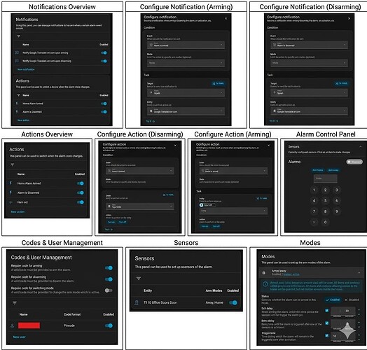

Thanks so much for your assistance. I have had a look at Alarmo, but unless I’m missing something, it seems to be pretty basic in terms of wanting to have countdown sound etc. I’ve been playing around with it and changed a few things for my TEST setup. Due to being a new user, this forum doesn’t allow me to post multiple images for now. But thanks to AI technology, I’ve got Google Gemini to combine and neatly create a large collage of images with clear titles for you :grinning: :nerd_face:
FYI, To make life easier for myself whilst I’m messing around, I’ve temporarily changed alarmo notification from my phone to output instead to on the google hub in my kitchen. I can fairly easily change the notification from my kitchen google hub to my android phone so that’s not the issue. I’ve also added the pin number to arm/disarm.
So the main issue is how do I get home assistant to automate the below sequence:

Hi, there is no need to repeat what you want to achieve.?
You can create an automation with the trigger when the alarm is turned on/off and add delays to the action.
Also, with an automation you can control more detailed what happens and where/when to send notifications.
Apologies Nick, I added the sequence because there’s a few minor changes, i.e entering pin code and the fact I want the countdown tone to be different from a standard siren.
That’s brilliant, but how do I acheive what I want to create as Alarmo doesn’t allow me to include countdown sounds/timer Could you kindly provide me with the steps to set this up?
