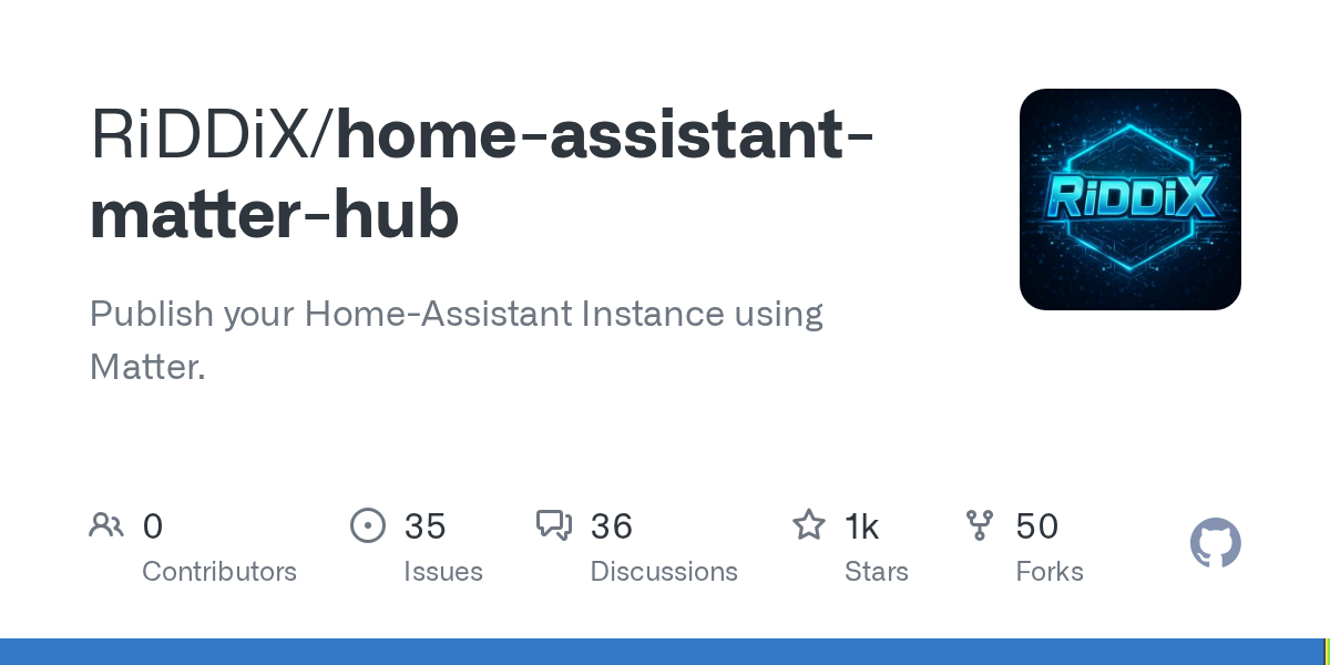

This addon lets you expose HA entities to Alexa, Google and Apple via Matter giving you full local control, no cloud, simple setup.
Thank you !
This is exactly why I use Smartthings. I use HA for some automation but ST for device exposure to Google and Alexa. Plus, my family prefers ST for better UI. Downside is ST isn’t 100% local. Matter hub addon’s dev said he’s not maintaining it and wishes someone to take over gives me another reason why I keep using Smartthings.
Above project is no longer matained

I just installed this and it’s pretty awesome and me proof! :slight_smile:
Exactly what I needed to migrate off of Smartthings but still have the Alexa voice commands.
