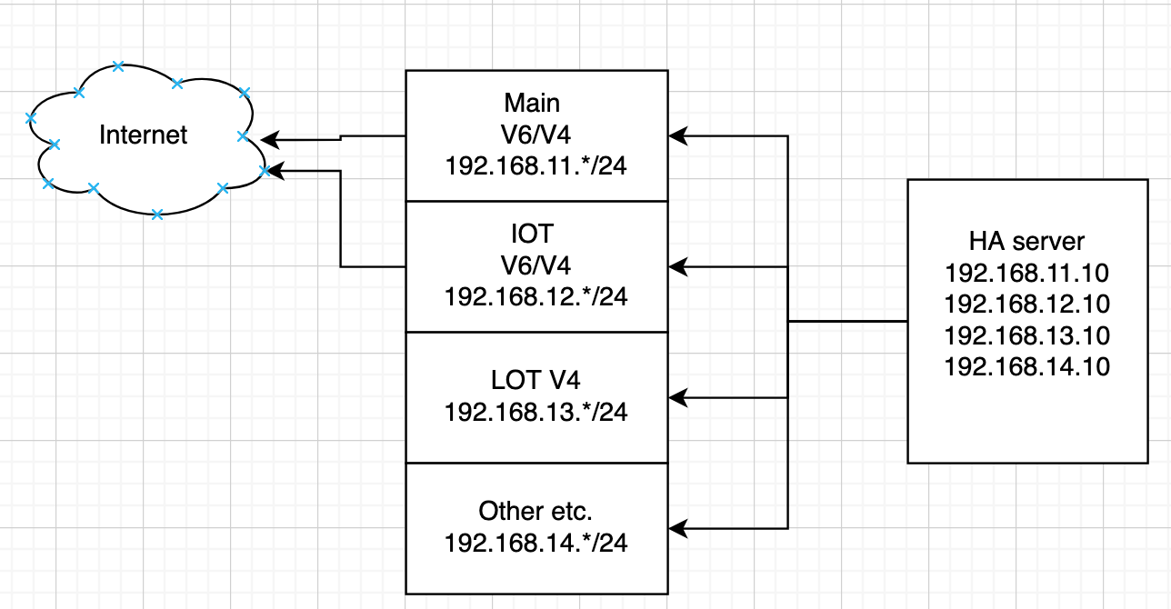

The easiest way to get HA to go to all networks have your HA server be part of them all.
in debian for example in /etc/network/interface you can add a vlan:
auto eno1.5
iface eno1.5 inet static
    address 192.168.14.15
    netmask 255.255.255.0
this way your HA server can go anywhere, but your devices cant.

Again give the server access to all vlans and you are golden. Nothing more nothing less.
Your phone or laptop does not need anything it can stay in your IPV6/V4 mixed main vlan and you really can safely put all the phone home stuff in a isolated network.
the simplest setup:
Sure there are better ways of doing it, but this works, LOT cant access the internet, but devices from Main can access them. HA/ESP/ etc. can do 99% of all the discovery protocols. If you are in docker you might get mDNS problems, but who needs that when you have a LOT/IOT network where you can assign static stuff.
The problem with the 4 VLAN setup is the HA server acts as a bastion into the Main and Other networks, so if the HA server got breached the attacker would have a route into both of those networks.
A better solution would be to only place the HA server on the IOT and LOT networks. You can then use a proper router/firewall to route traffic between Main, IOT and Other networks - i.e.: You access the HA UI from the Main network using its IOT address: 192.168.12.10
Note: I am not clear what services you are running on “Other” so something special might be required for that.

That is fair, But as a hacker, a bank might be nicer to go after or a person that has HA open to the web on the router with port forwarding.
I only have my VPN port open on my router so there is a chance its not 0, but its also not something I am concerned about.
This would be a decent improvement to the setup, not sure if figuring all the FW stuff out is doable for a average HA enthusiast, but also if HA has a zero day in the front end its still a bastion…
Was more a example, perhaps you want your kids to have this vlan with a special DNS server that filters traffic. Or guest network you could then remove this vlan from the server. endless possibilities.
