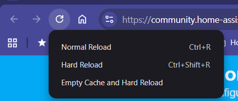

If it doesn’t, open chrome dev tools (F12), then go back to your HA browser window, right click on the refresh button & select Empty cache and hard reload.
