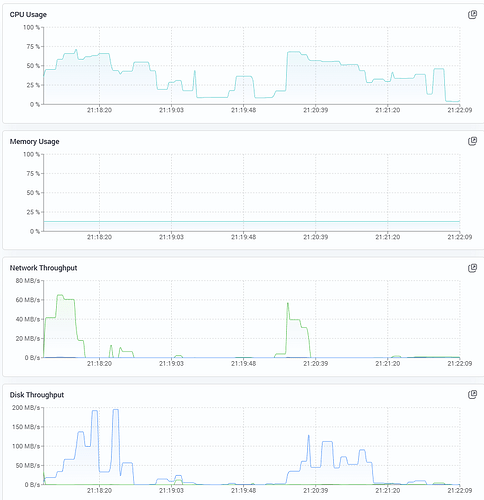

no apparant issues on QNAP (i3) and KVM - VM 6 mins
