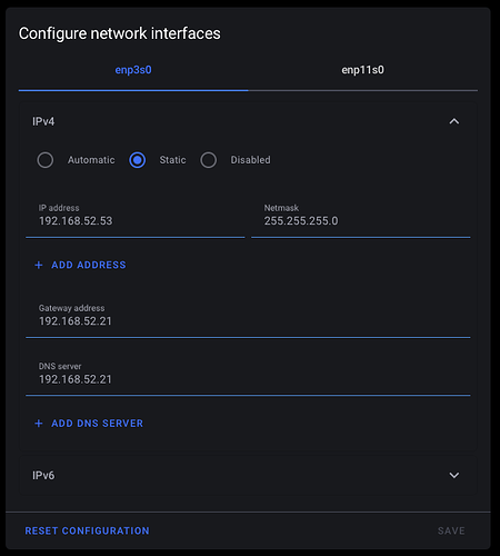

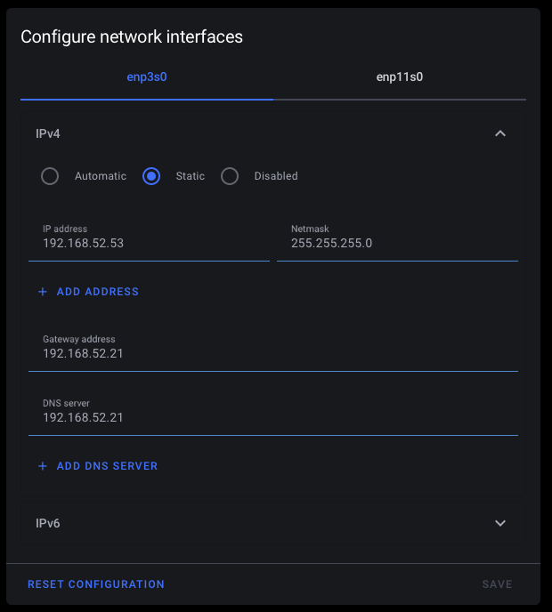

Can you make screenshot of your HA network settings? Seems like mismatch between router and HA network settings. Nine looks following:

I don’t have HA NIC set to DHCP. I have it set to static IP of 192.168.1.39. Router is configured to give out DHCP addresses starting from 192.168.1.100 and up.
