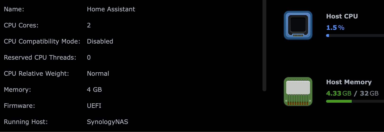

Anyway, I had some issues, but I upgraded it, but now the backups are broken because of some WebSocket issues or whatever. So I wanted to try the supported HA OS way. Got VMM on my NAS, created the VM, etc.

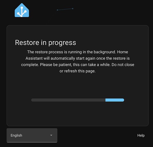

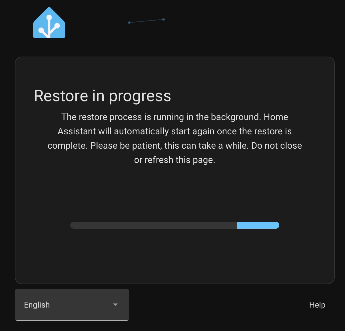

All good except the restore process without any information of progress has been such a painful experience! There is initial progress when HA OS downloads the HA image - why not keep it for restore?....
I initialized the cloud restore as the backup is quite fresh from May 19. I started it maybe 3 p.m. yesterday- it's now 8am I am waking up to a disk usage of 31.52 GB / 32GB and the progress still bouncing from side to side...

Can't you click on that blue bar?
Could I? Nothing in the UI told me to. Once it got to the full disk it crashed and I trashed it. Are you blaming the user now? lol
I don't know an app that would hide information behind a progress bar that should be clicked to get one...
I connected to the VM. I think I did "jobs status" but didnt' see antyhing helpful in there and I'm also unable to scroll the view after connection.
No. Don't go that route. I remember this was once a circle that you could click to get progress information. It was a genuine question. I don't use this process enough to know for certain. The HA UX is certainly not perfect.

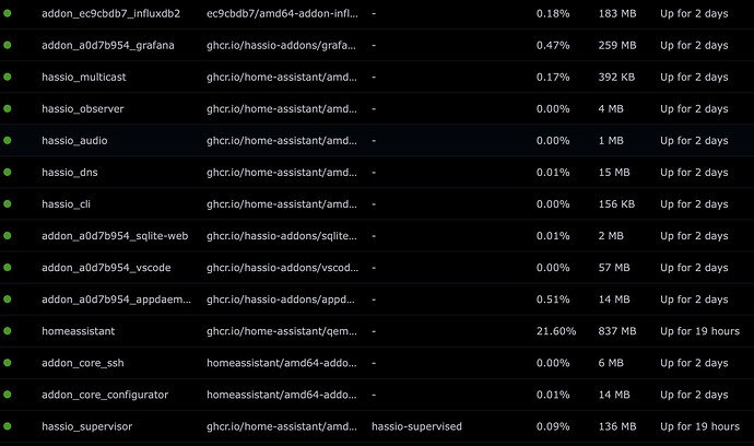

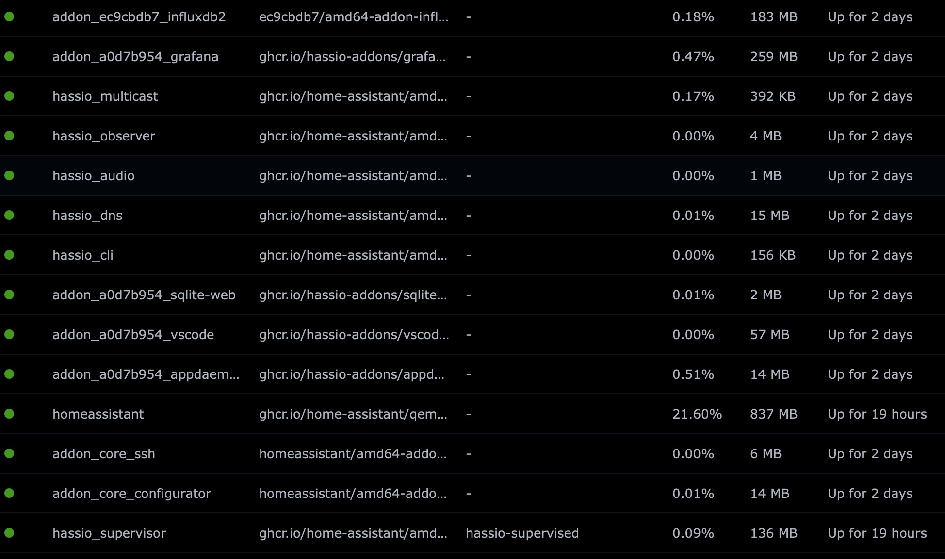

For now I managed to fix my Supervised Docker install on Synology NAS. Unsupported is a state of mind lol
I got the backups running.
The key was the last mount I did not have propr to 2026:
        volumes:
            - '/volume1/docker/homeassistant:/data'
            - '/var/run/dbus:/var/run/dbus'
            - '/var/run/docker.sock:/var/run/docker.sock'
            - '/run/supervisor:/run/os'
Although the supervisor is crashing every couple of minutes. Onto it.
