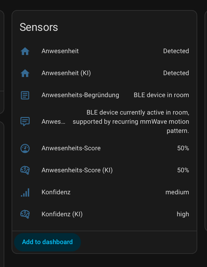

So I built HA Soft Presence — a custom integration that fuses all the sensors you already have for a room into a single, debounced binary_sensor.<room>_presence_soft with a proper state machine behind it. You configure each room once through a UI wizard; it creates the presence sensor plus score / confidence / reason sensors you can build automations and dashboards on.

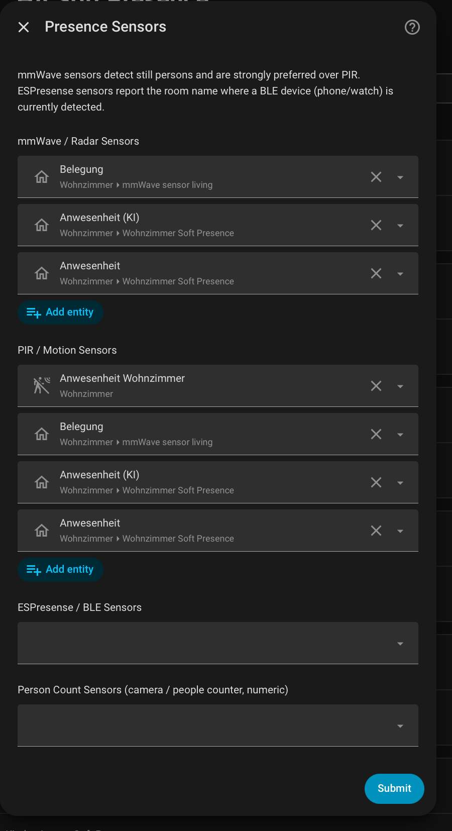

  • Sensor fusion — combines mmWave, PIR, ESPresense/BLE room, camera person-count, doors, windows, locks, media players, lights/switches and workstation power into one weighted score.

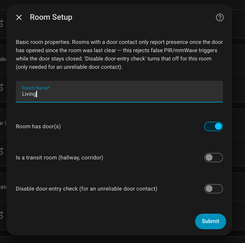

  • Door-closed lock-in — if the door has been shut since you were last seen, the room stays occupied even when you sit dead still (where mmWave often loses you).
  • Entry-gate — the flip side: a closed door that never opened proves nobody entered, so a stray PIR/mmWave trigger can’t mark an empty room occupied. On by default for any room with a door contact; per-room opt-out for an unreliable contact.
  • Transit rooms — hallways clear fast and never lock in.

  • Diagnostics + Repairs — every room exposes its live score / reason / active sources; misconfiguration surfaces as an HA repair issue.
  • UI config flow, per room, with fields pre-filled from the matching HA area. Translated into 11 languages.

Each configured sensor contributes a weight to a 0–100 score. Cross occupied_thresholdOCCUPIED. Drop below clear_threshold → start the timeout → CLEAR. The door lock-in, entry-gate, sleep mode and transit rules adjust the thresholds/timeout around that core. A manually-on light counts only as weak supporting evidence — it can never hold a room occupied by itself.
