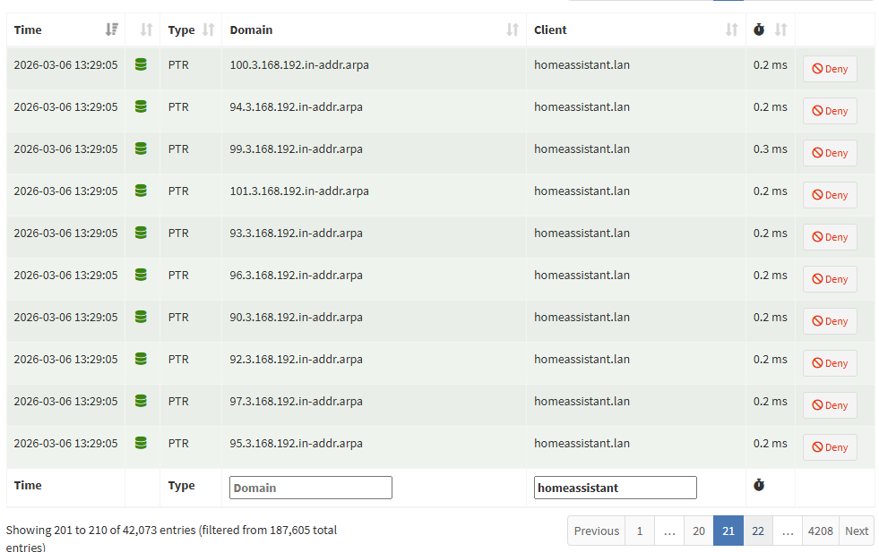

I did a little digging in the query log. It is not looking just for local addresses. Here is a sample:

  • The .in-addr.arpa PTR lookups are local addresses, but in reverse order. So the lookup for 192.168.3.4 would be 4.3.168.192.in-addr.arpa. This is normal: https://www.whatsmydns.net/dns-lookup/ptr-records
  • The PTR lookups are for every address on the network to try find hosts. My network is using a subnet of /21, which would be 2,048 addresses and PTR lookups when it is attempting to discover hosts.
