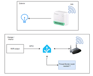

I’m not sure to understand your current topology and what you want to achieve, would this diagram be exact ?

Thank you for such a detailed welcome! I’ve created a small diagram of what I’d like to achieve.
Since the MINIR4M is a WiFi device, it seems that a Thread network may not be necessary, but if you could try it out, that would be great. I also read through the Matter integration guide Matter (BETA) - Home Assistant
