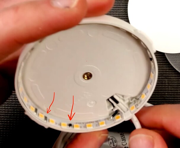

Teardown of the LED spot shows for each (see pics):
  • 2.2W / 24V / 91,6 mA / DC
  • 28 white LEDs inside
  • 3 diodes
  • 4 resistors
With this:
  • 4 LED strings containing
  • each of them 1 resistor and 7 LEDs
Following this teardown video:
I do not know if the spots are connected in series or parallely.
I hope this helps you helping me? :slight_smile:

I watched it now and it confirms what I thought. It is a simple, analog LED, which means there is no fancy stuff to change colour or colour temperature. It is simple one colour and dimmable. H801 RGBW LED controller — ESPHome
The dimming is done via PWM. This is ideally suited to the H801 I pointed out to you before H801 RGBW LED controller — ESPHome. They are cheap from Aliexpress and reliable and well made. Even though they labelled RGBWW you can put any colour on each output (as the above link points out). They handle 24v, so ideal.
I have done a low quality drawing here, and also include my own yaml for a similar setup where I am running a number of analog strips on some stairs.
