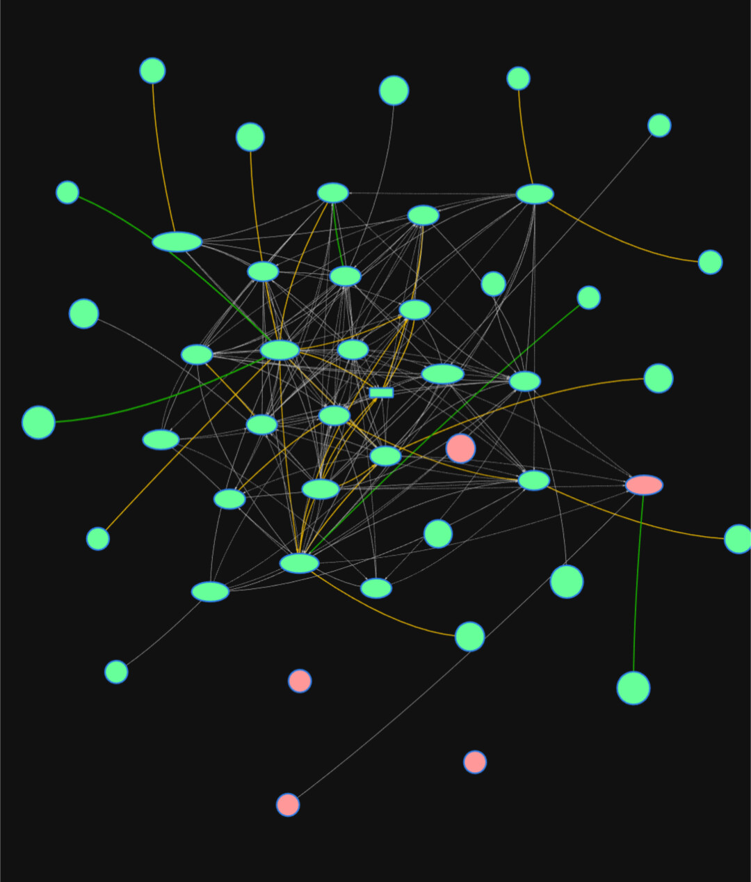

Ok. I am definitly in a better spot with my topology! I added 4 Tradfri bulbs and 2 outlets spread out over the entire home. Thank you again for the assistance with this.

Start here and follow the advice provided in that thread, especially the wifi interference part.
