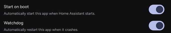

But my z2m watchdog is enabled! (see screenshot in comment)

z2m Watchdog enabled
Hi rootjumper you have to make the following settings in the configuration under watchdog. To do this, click on Show unused optional configuration options and then enter the following, for example 1,5,15,30,60
Hey Mate,
Thanks for that information.
I just set those values as you said.
We see and big thanks, i dont know how i failed setting these values…
Thanks! I’ll give feedback if that solves my issue.
Update: Solved by setting the watchdog parameters.
I ran into this myself.
Sorry, what do you mean by “I don’t know how I failed setting these values”?
It’s completely understandable you didn’t set them: there’s a switch on main plugin page that says “Watchdog: will restart add-on if it crashes”. It obviously isn’t sufficient to turn this on and it’s completely opaque from the GUI that some hidden config vars need to be set to a list of timing values.
This is bad UX.
EDIT: I read the documentation and it’s described there. It’s still bad UX. The switch should do what it says… why not add “watchdog: default” when the user toggles that switch on?
Thanks a lot to @Igel82 for the solution!!!
I’ve been struggling with this for months. Also assumed the watchdog toggle wasn’t lying. Bad ux indeed.

I have both options set: in app and watchdog started
But it just crashed and never restarted:
