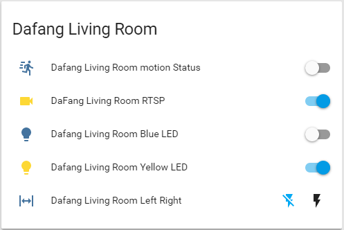

alternatively, removing the state_topic and value_template will show flash icons for controls, so it’s technically possible to use just 1 switch to control both directions: off = left, on = right. Only thing is I don’t know if if it is possible to change these icons, but here’s how I’ve down it:
- platform: mqtt
 name: "Dafang Living Room Left Right"
 command_topic: "LivingRoom/DaFang/set"
 payload_off: "motor_left"
 payload_on: "motor_right"
 optimistic: false
Here’s the result:
