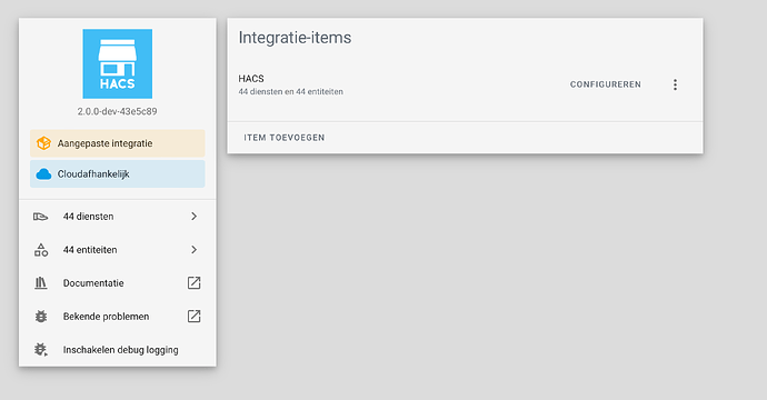

settings:
version, and all services/entities are alright :

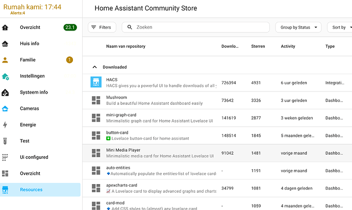

With default setting in the sidebar, still no show:
edit
thew above is on Mac Safari.
I can see HACS in Chrome
Issue tracker: Dashboard not showing in Safari · Issue #3914 · hacs/integration · GitHub
edit
this was fixed by hard deleting the hacs line s in local storage

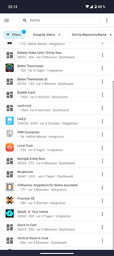

Hey
Ive found a Bug. In the mobile App (Android) the last entry in the list is covered.
There you can See There is one more entry at the bottom. But cant scroll down more
