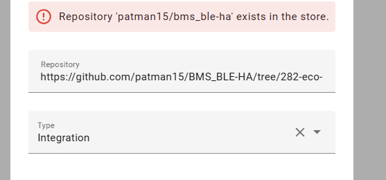

When I try to add a specific branch of a repository it says that the repository already exists … How do I get rid of the main repository from HACs then ?

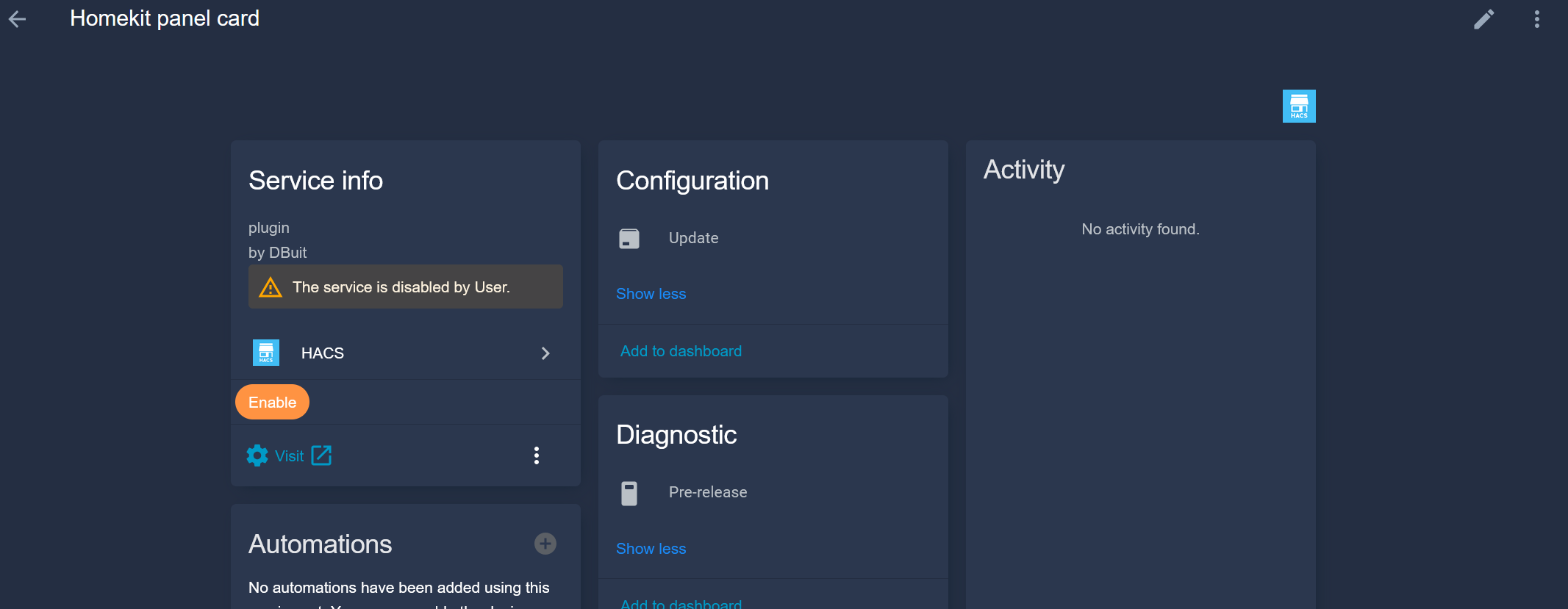

Someone has an idea how to fix/solve the following regarding HACS:
In the past in added some custom repositories. But i dont use these anymore so i want to delete them to keep HA clean.
My first thought was that i would go back to the HACS hamburger menu → custom Repositories and press the red bin to delete them. But only 1 item is showing there. All previous ones (that are still there somehwere) don’t show up.
When i navigate to “settings → devices/services → HACS” i can still see the “old integrations” i want to have deleted. But also no option there (only a disable option).
Also when visiting via “devices” i see the old ones but also no option to delete it or remove the custom repo path/url.
Example with this one:
How can i make sure to delete these ones? Where/how can i remove older custom repos?
