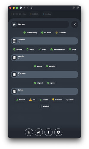

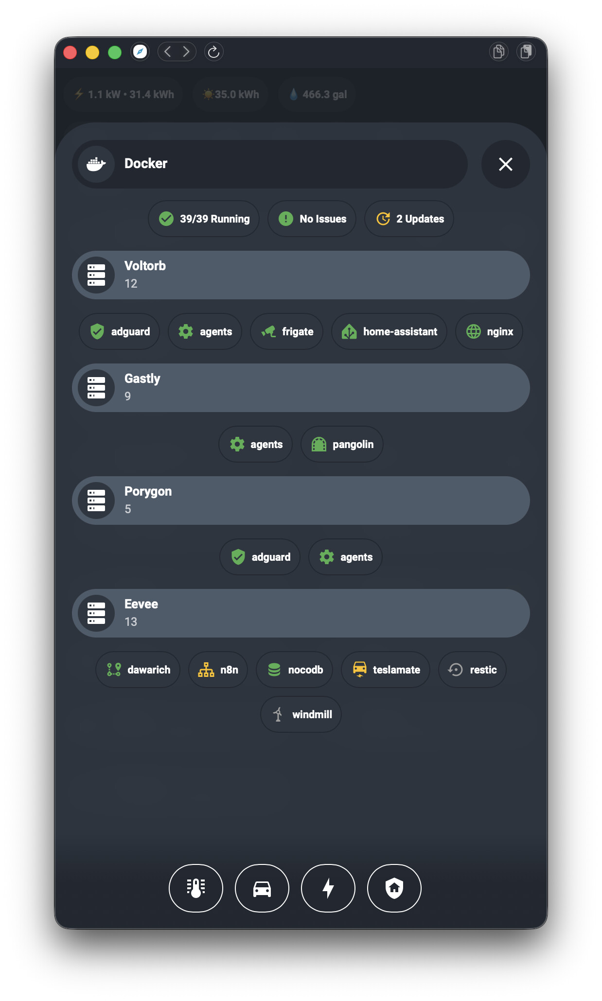

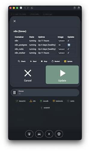

  • Dashboard card — a custom Lovelace card that auto-discovers all servers and stacks, with real-time status, popup actions (start/stop/restart/update), and a processing indicator that pulses blue while operations are in progress
Each Dockge server gets its own device with child devices per stack, so everything is cleanly organized in the HA device registry.
Screenshot

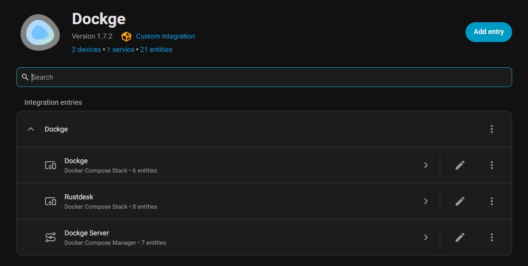

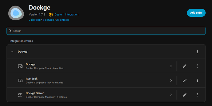

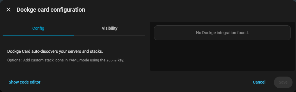

Hey, just came across your Dockge Monitor, thanks for sharing, I was able to get the integration and card setup, but the card displays no integration found, any idea what the issue mite be?
