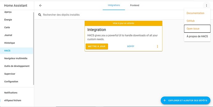

I install HACS following this [[TUTORIEL] HACS : installation dans Home Assistant – Les Alexiens]
once installed, i got the HACS menu in the side bar, however after HA restart, when access to integration, i got msgbox “need to updated to the least version”, which i did.
I’ve got Errors in Logs once updated finished and also the HACS menu has disappear from the side bar.
