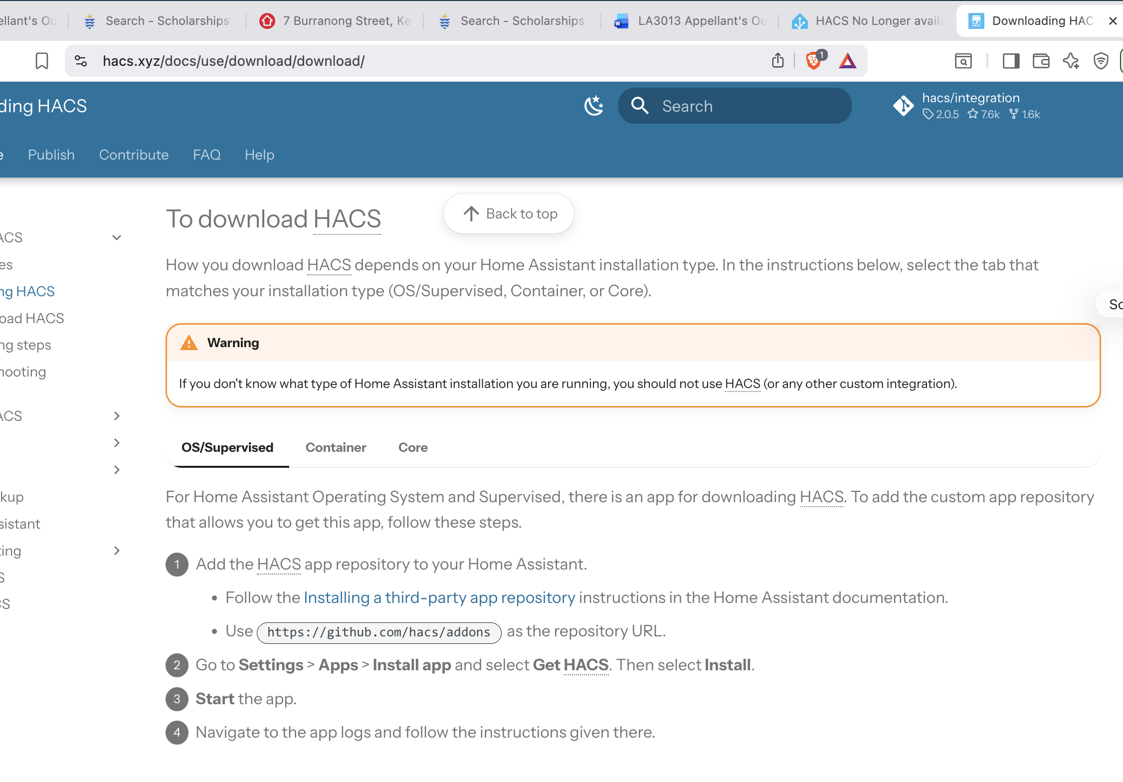

If you struggle with the official HACS install, post the step you are having an issue with.
Thank you for replying.

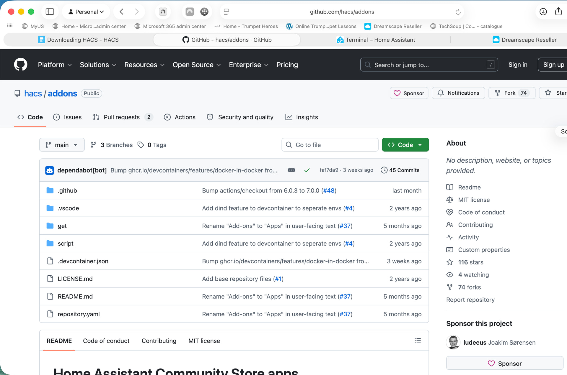

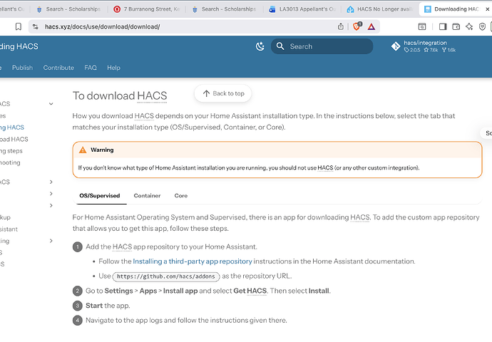

I went to the page shown and think what i need to do is download then install into HA but I haven’t done this before. I also can’t see any reference to HACS in my HA installation

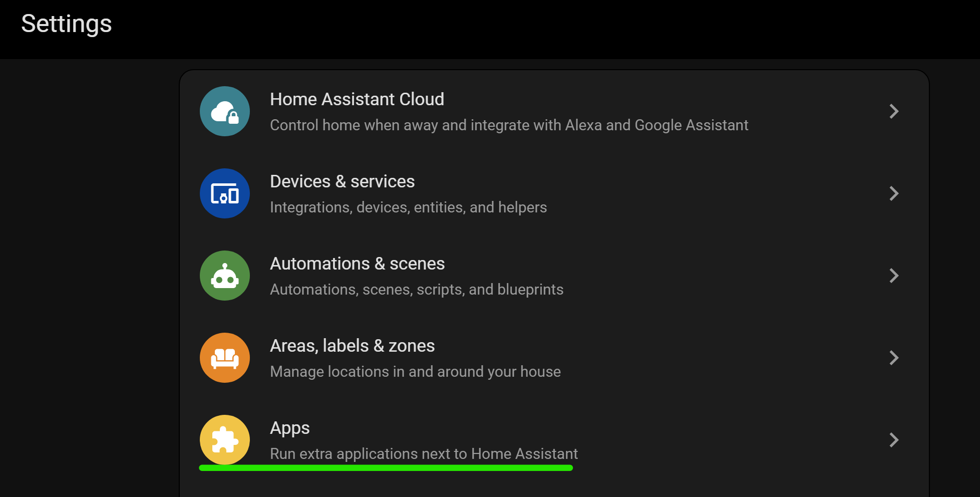

I did find this
Go to Apps menu in Settings/Apps
Select Install app in the lower left corner
Do you see this :down_arrow:?
If not you missed this step

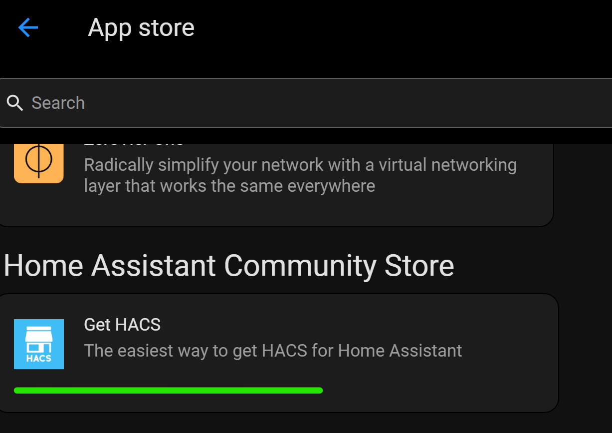

For Home Assistant Operating System and Supervised, there is an app for downloading HACS. To add the custom app repository that allows you to get this app, follow these steps.
  1. Add the HACS app repository to your Home Assistant.

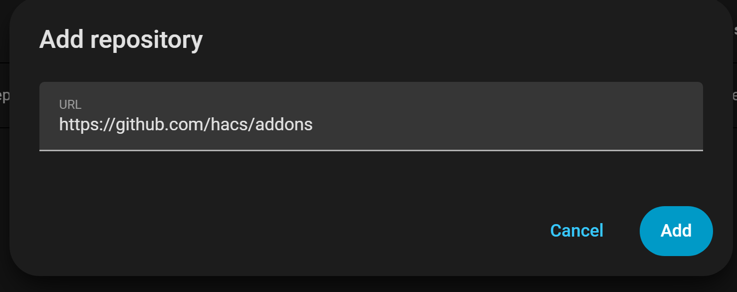

No problem, if you don’t see the App go to the 3 dots in the upper right hand corner on the App store screen. Click repositories, then Add. Enter GitHub - hacs/addons · GitHub in the url field
