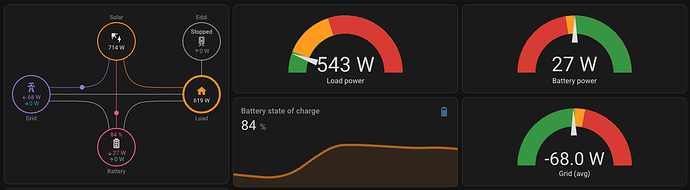

I have 2x Growatt MIN-3600 inverters connected to Solar Assistant pumping data into HA via MQTT, so far things on the HA side going great, I even managed to set up a realtime energy dashboard.
My issue is that the GRID values coming from Solar Assistant across the two inverters needs to be the average of the two inverters, not the sum. I’ve asked Solar Assistant if they can do anything about this, but in the meantime I thought I’d try and see what I could do to mitigate in HA.
I managed to create the grid (avg) sensor shown in the above image, works fine!
However, I want to be able to do the same for the day total figure that gets used on the energy dashboard.As all of my totals are ~double what they should be…
