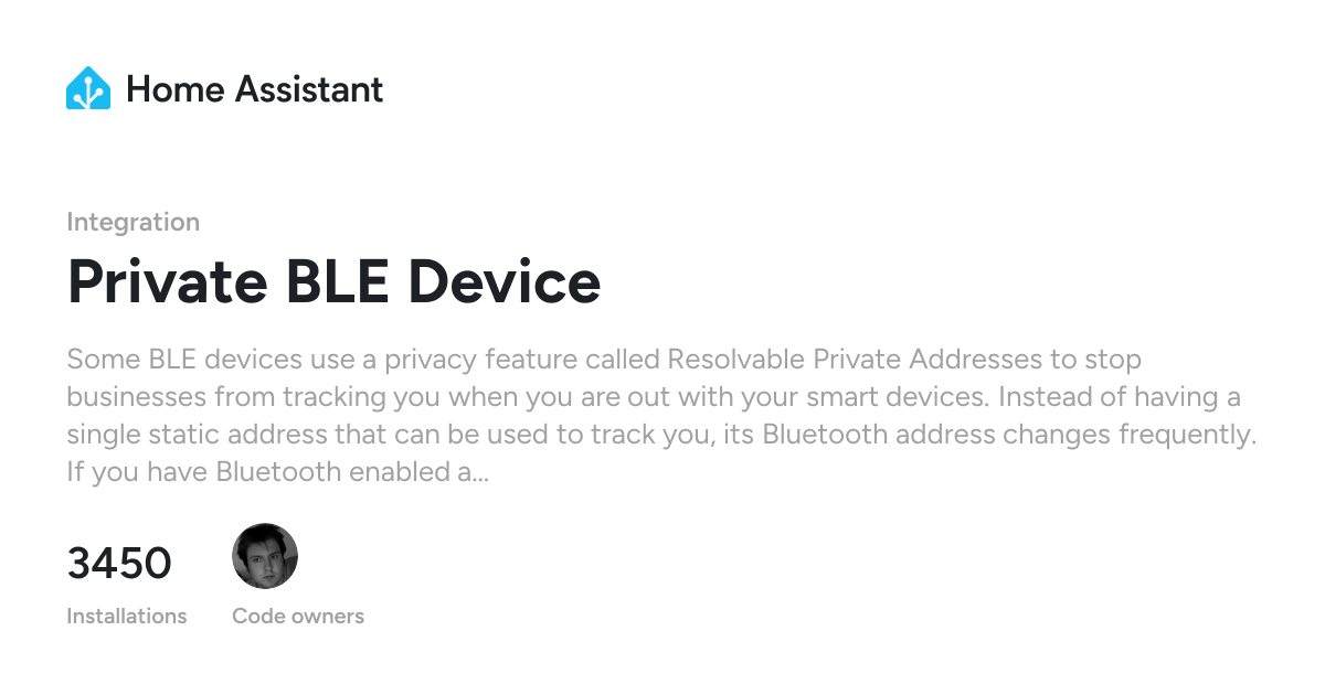

i use a combo of homekit presence and private BT. One or the other may miss occasionally, but I’ve never had both of them miss as at the same time and they are both snappy.

This is the way to go. With BLE you can even get room presence if you want :slight_smile:
