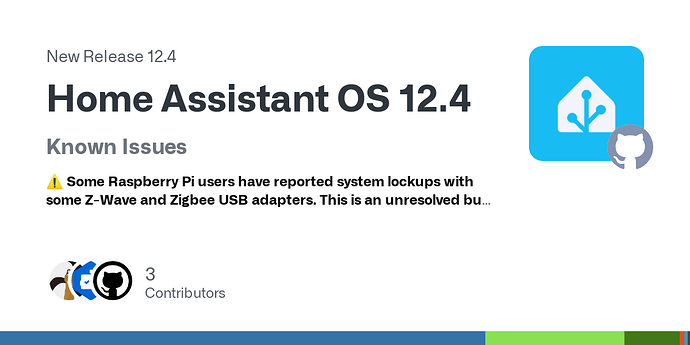

Reading the release notes more carefully, shows a declared issue which could be shouted out more loudly:
Some Raspberry Pi users have reported system lockups with some Z-Wave and Zigbee USB adapters.
Yes - that “some” seems to be Yellow users using any USB devices!
