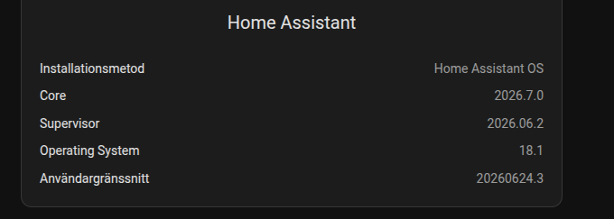

Maybe I'm lucky or don't fit the requirements to expose the issue, but I have HAOS 18 running in a QEMU/KVM VM on an RPI5 8Gb (ethernet) with the matter integration, with no issues...
In general, already HAOS 17.3 used end0 as naming for the Ethernet interface, so there is nothing new. The apps also get the primary interface through Supervisor dynamically, whatever NetworkManager reports as primary interface. So even if the interface name changes, the apps learn that last name at runtime.
In general I ran my production on Yellow with CM5, and have a test system where both apps work fine. There is not a generic problem here.
This must be a system specific failure. Maybe Z2M accessing the same serial device? Can you share the logs when the OTBR/Matter Server doesn't start?

I am running HA, the latest and the greatest.
With two Sonoff usb dongles in a very tight env.
With a RPI 3B with just 1GB
With Matter with threads (one Sonoff) and Zigbee (the another Sonoff), and it all working well.
One thing that I haven't configured that I don't use is IPV6 network, so my RPI is configured like this:
