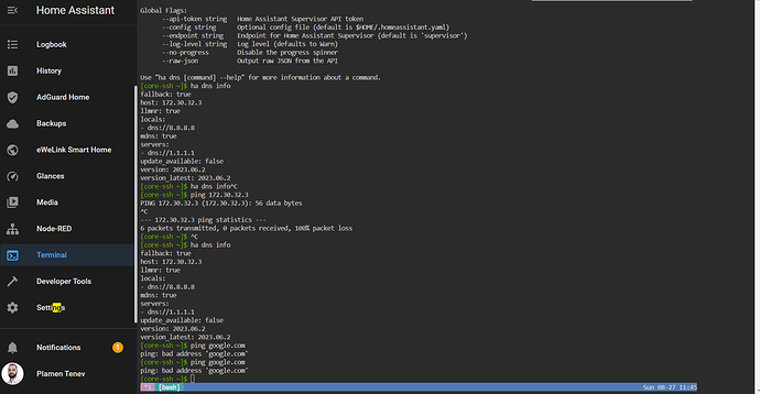

The issue that I’m facing is for HAOS.
I am struggling to get Ewelink Addon, TTS and some other stuff to execute requests. I suspect this might be DNS issue, since I have also VirtualBox installation and there the Ewelink & TTS are working. Via terminal, pinging addresses like google.com gives me the response bad address:
I’ve read articles and I tried the following:
- Disabling IPv6
- Disabling AdGuard
- Changing DNS from one provided by the router (which fallbacks to the HAOS machine local IP) to 8.8.8.8
- Executing:
ha dns options --servers dns://1.1.1.1
ha dns restart
(DNS issue: unable to connect to raw.githubusercontent.com?)
Any help will be much appreciated. From my point of view the issue was present out of the box with fresh installation. I thought that it might be resolved via an update, now I think, this will not be the case.
