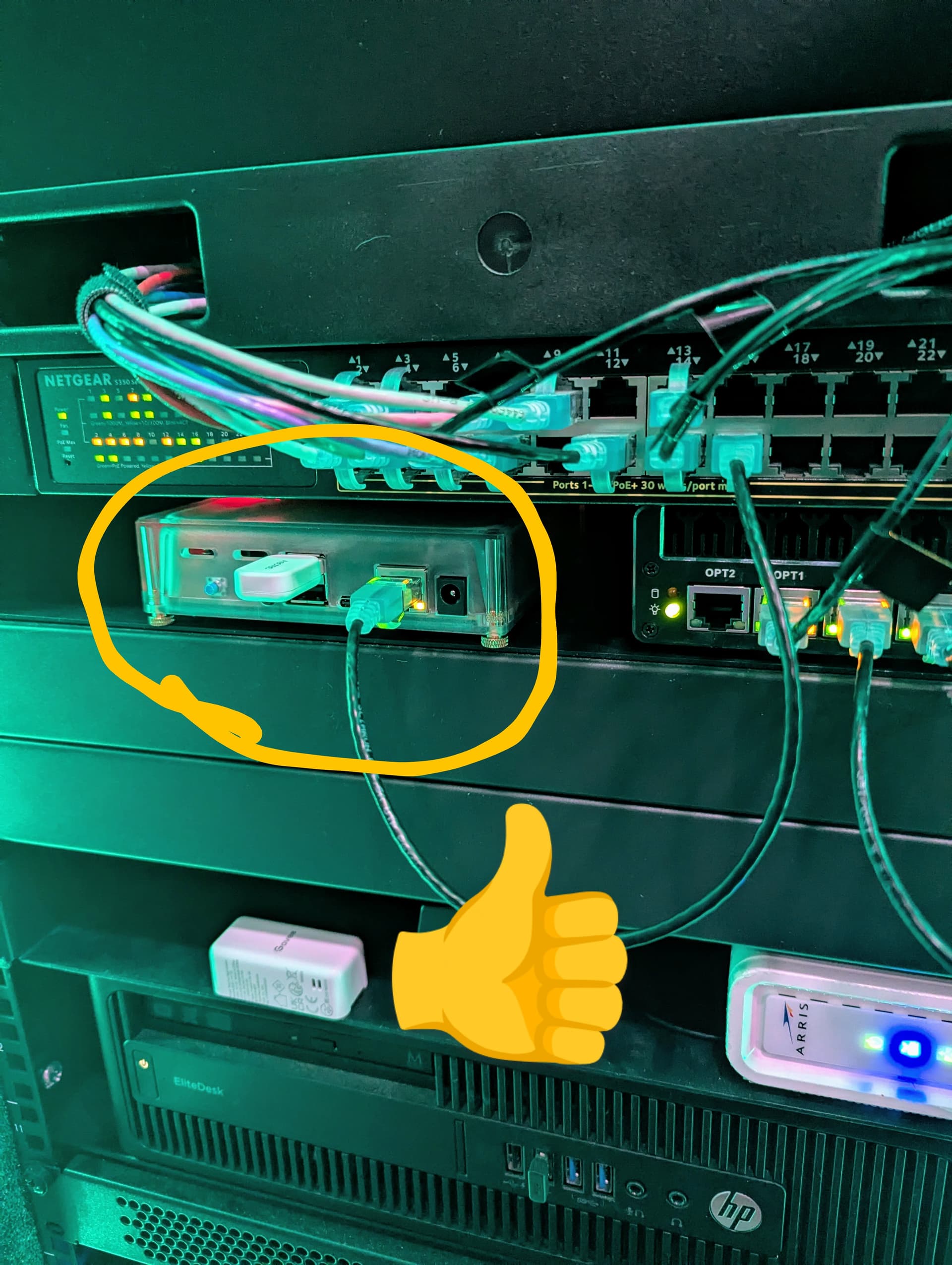

Hi. I have a Raspberry Pi 3B+ running HAOS latest production release. Been having this problem for at least a year and it keeps getting more frequent and worse. At this point, it is bombing out hard once a day at least. Becomes totally unresponsive, and eventually restarts. There is no consistent event that perpetuates it. I already replaced the SD card with a Max Endurance card.
Hardware info show’s 0.7 of 1GB in use and 4% processor. The only add-on that is running is ZwaveJS-UI. I have Samba and terminal, but only start them when needed. Today’s crash was in the middle of the work day while I was not even home and not interacting with HA. No automations run at that time. None of my automations, scripts, integrations have errors and all work fine routinely all day every day. So I don’t think it’s something of mine making this happen.
The pi is powered via PoE. But I’ve tried it with a separate USB power to no avail.

Understood and accepted that my old Pi 3B is no longer able to handle the power house that Home Assistant has become. Problem solved in the form of HA Yellow. Zero crashes and everything runs faster and better. I didn’t know how slow and crappy my system was until it wasn’t anymore!
