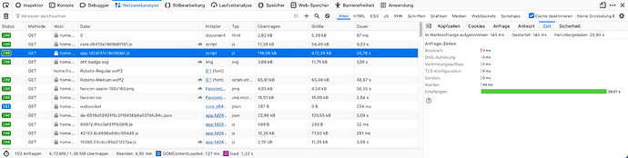

For some files, mostly the static files, it can take multiple seconds to get a response. Look at this: it took almost half a minute to transfer a 100 KB file!

Hey kytta,
Well written post and it is clear you troubleshooted thoroughly before posting.
Normally I would say it is likely an SD card issue, however you already tested that.
For good measure: can you boot up a VM on your laptop/desktop and restore one of the HA backups you have in there & then test the UI? If that works smoothly it has to be something on the PI.
Another thing you can try is to remove the tailscale connection if it is running locally on the PI and test again. It shouldn’t be the case but perhaps it may have some routing issues.
What other devices do you have plugged into your raspi?
