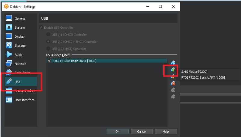

I use usb passthrough in VirtualBox for a Zigbee stick to my debain VM to run Zigbee2MQTT. I also only run in headless without a desktop environment. Did not have as much luck trying to get passthrough to HA while running HA in a VirtualBox VM. I think this is due to the requirement to have VirtualBox Guest Additions installed in the VM to get USB Passthrough to work.
All you have to do in VirtualBox after you have Guest Additions installed is go to the VM’s settings, then select USB in the menu on the left. Then just click the icon with the green plus sign and you’ll see a list of all the USB devices connected to the host. Just select it and bam, you’re done.
Once you do, the device should show up in your /dev directory like it would if it was connected to Ubuntu directly. I pass my zigbee stick off to a container running Zigbee2MQTT.
