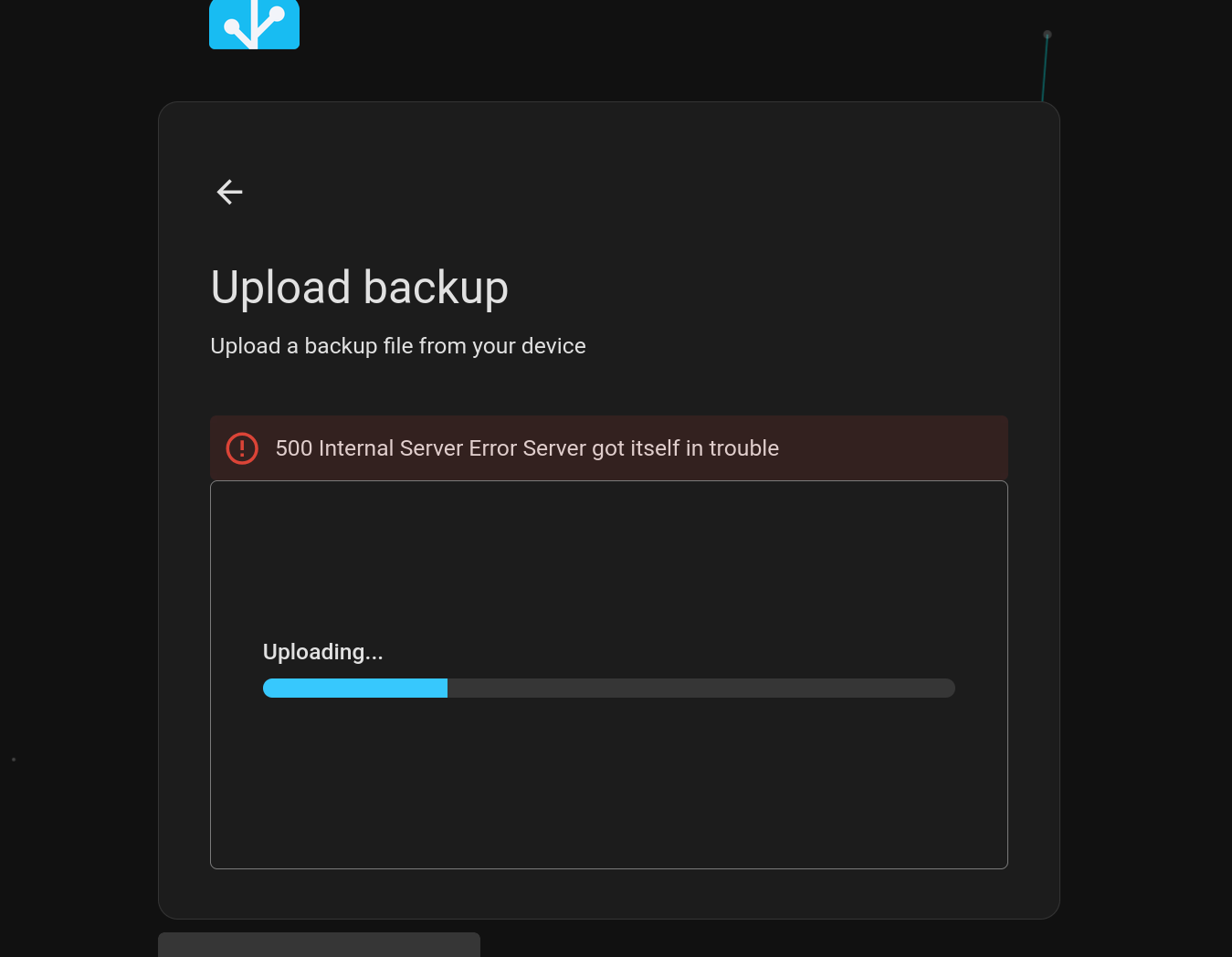

hello,
I was running haos on an old pc just dedicated to that because on my ugreen dh4300 nas there is no VM to be able to install it and via docker it wasn’t great. so I tried installing haos-one on my nas like this “docker run --name haos -ti --privileged --network host -v./data:/mnt/data qweritos/haos-one” then integrated the latest haos backup from my old pc and it seems to work. it’s been working pretty well for two days, even my sonof matter key works. bravo and thank you for this version
Thank you! Will try again!

It ran into trouble trying to upload a backup from my proxmox vm haos.
@qweritos Any thoughts on why the restore from backup is failing?
So of course once I actually post a followup question and decide to try things one last time it works fine with a new backup. No idea what the deal was but happy to get farther in trying it out.
When you initially launching the instance and restoring from backup, the whole lot of container images/layers being downloaded one-by-one, so the registry provider may throttle your bandwidth. Consequently, it takes a while to restore all the stuff, especially if you previously has lot of apps(addons) installed.
You can track download progress in journalctl, the supervisor drop some lines when it start and end downloading next image.
So, if there’s a record about begin download and no related trailing line - most likely the downloading is undergoing right now.
You can track image downloading progress by ctr image pull <image:tag>
I’ll try again and just leave it running for a while. I left it for several hours and it was conflicting with my existing vm since they had the same “id” which made me think it was done but no ui was available. Above and beyond that the fact portainer stops working when haos-one is running is my main issue which may involve having to put it in it’s own docker lxc and at that point it’s just as easy to install haos directly to a mini pc I have lying around here.

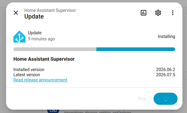

Thanks, I adjusted the the compose file to latest.
Now it get’s stuck on updating the supervisor:
The screeshot only shows it running for 11 minutes, but also after hours nothing happens. I can’t see anything useful in the logs.
@futurebuddha , Check it with
journalctl -n all -f | grep -E 'Downloading docker image|msg="image pulled"'
if you see the line like
... hassio_supervisor[235]:...  INFO (MainThread) [supervisor.docker.interface] Downloading docker image ghcr.io/esphome/esphome-hassio with tag 2026.8.1.
but no line
... hs2 dockerd[235]: time="..." level=info msg="image pulled" digest="sha256:a2453d8b653258e84f307cff5e767f46249501e38e437e44ec977fd5275314be" remote="ghcr.io/esphome/esphome-hassio:2026.8.1"
then it seems like it being pulled image. To see progress, you can start parallel pull (containerd will handle this - you’ll be attached to existing pull job).
ctr image pull ghcr.io/esphome/esphome-hassio:2026.8.1
and you’ll see the detailed downloading progress.
If it can be solved by removing “network_mode: host”, this most likely related to Mac OS - Network Host · Issue #45 · qweritos/haos-one · GitHub
I working on the stable workaround for this issue.

The grep showed nothing. ctr imag pull did download something, but it changed nothing.
Thanks for trying, in the end I made a backup, deleted the data folder so it reinstalled and uploaded the backup.
I’m afraid I didn’t have to time to trying to understand what’s going on.
