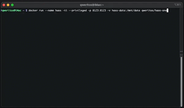

[haos-one] Run Home Assistant OS in Docker Container (for those migrating from depricated Supervised)
As you may know, the Supervised installation method has been deprecated.
So, I built haos-one : a single Docker container that runs Home Assistant OS with Add-ons.
intro-ezgif.com-speed
No dedicated hardware or VM needed.
For ex-Supervised users who want full-featured Home Assistant running next to other services.
Try it:
docker run -ti --privileged -p 8123:8123 \
-v ./data:/mnt/data \
qweritos/haos-one
Works on x86/ARM hosts, supports rootless containers
Feedback welcome.
Glad if you find it useful!

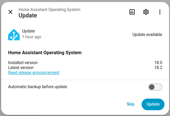

I try to update haos from 18-18.2:
but it fails with the message: Failed to perform the action update/install. Error updating Home Assistant Operating System: ‘OSManager.update’ blocked from execution, supervisor needs to be updated first
I did a docker pull and restart. Also I tried in the docker container via
sudo docker exec -it haos bash
/ # ha supervisor update
Processing... Done.
Error: Abort update because of an issue with AppArmor: Can't update AppArmor profile!
Am I missing something? I don’t know what to do.
