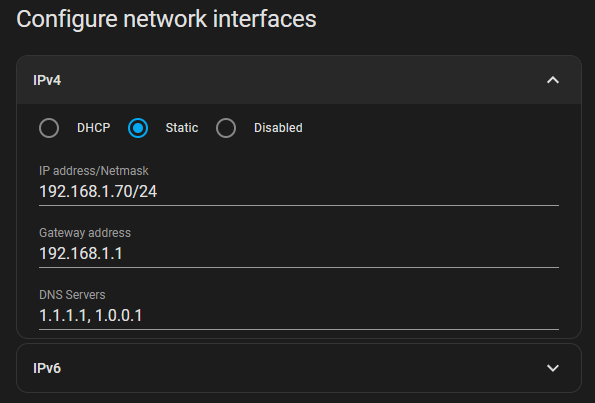

The problem appears to be within Home Assistant (or how it’s accessing the network via the VM) but I’m not sure where. It has a separate IP address to the Server: Home Assistant is set to use DHCP and my Router is setting a static IP of 192.168.1.70.

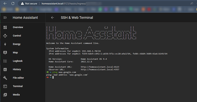

All signs point to a HA Supervisor DNS issue, which makes sense given that the VM’s CLI works just fine.

This could be related to Eero routers, which I have. The issue is HA incorrectly detecting the DNS nameserver from the router - and this appears to be correct, if I run HA in DHCP then it detects the Router’s IP instead of the correct DNS nameservers. But I’ve already configured HA to use a Static IP and the DNS servers:
So running ha dns info shows the correct DNS servers:
But it still does not work, and the fallback suggests that something is failing?
