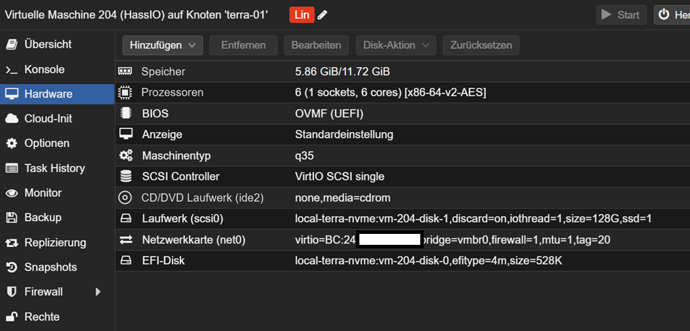

  • Home Assistant OS as a VM on Proxmox, HA across 3 nodes
  • Timezone: Europe/Berlin

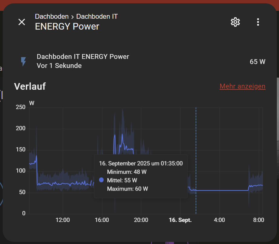

  • On multiple nights, at a varying time during the night, history recording stops (e.g., temperatures flatline).
  • By morning the HA web UI is unreachable.

  • The VM now has 12 GB fixed RAM (ballooning disabled).
That is all I have verified so far. If you can point to specific log files/entries or a targeted command you want me to run (e.g. under /var/log/pve/tasks/ or a qm agent check), I will run it and post the sanitized results.

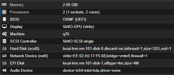

You are using VLAN. Make a copy of the VM and try without VLAN and without setting MTU. You do not need 6 cores, 4 are enough. You also try to set the processor to host or kvm74 (if memory serves me well your current AES setting can cause issues to HA).
See below an example of a working VM.
