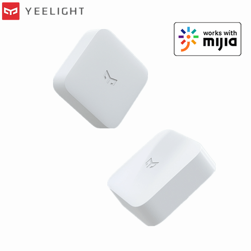

I just installed this inexpensive Yeelight YLAI003 Bluetooth Low Energy button. Costs about $8.
It works great and supports single press, double press and long press. Requires a Bluetooth adapter on your HA host and this custom component:

I purchased these Yeelight Switches YLAI003 too, since February 2024 (HA Version 2024.2), they can easily be integrated into HA with the official HA Xiaomi BLE integration. No more need of the passive BLE integration. Single/Double/Triple press events for the switch are availbe out of the box.
Here is a little insight, where I struggled before. It might prevent other users of losing time :smiley: Be aware, you must add them to the Xiaomi Home App first, and the Xiaomi Home App must be set to region China, else it wont discover these BLE Buttons. Then, use the Xiaomi Token Extractor Tool, linked in the above mentioned integration to get the Token/BLE Key.
The Telink Flasher cannot generate a Token/BLE Key for this YLAI003 switches unfortunately, so don’t waste time here, it took me quite a while to figure out I’m not doing it wrong :smiley:
