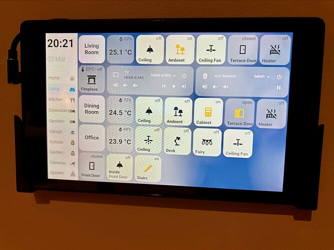

Could you share examples of your dashboard for tablets? Code fragments or pictures are fine.
Sure, here is how that looks like:
This is a Fire 8 HD tablet running Fully Kiosk browser. The tablet nevers sleeps, but dims after a minute and goes back to full brightness as soon as the camera detects motion. I built a custom dashboard for the tablet using button-cards, sidebar-card and kiosk-mode to hide parts of the UI. And I am using browser-mod to display notifications, for example when someone presses the doorbell I show a full-size popup window with the doorbell’s camera view.
The main dashboard shows the most important sensors and controls.
And then I built more detailed dashboards for the various rooms, garage, garden, etc.
And here without the tablet:
I am using Dockem Koala wall mounts which are very small and let me easily remove the tablet when necessary. I have access from behind the wall and am just threading a USB cable through a grommet to permanently power the tablet.
