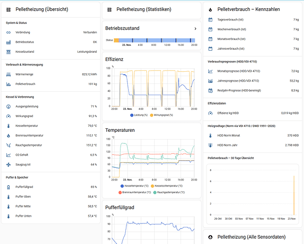

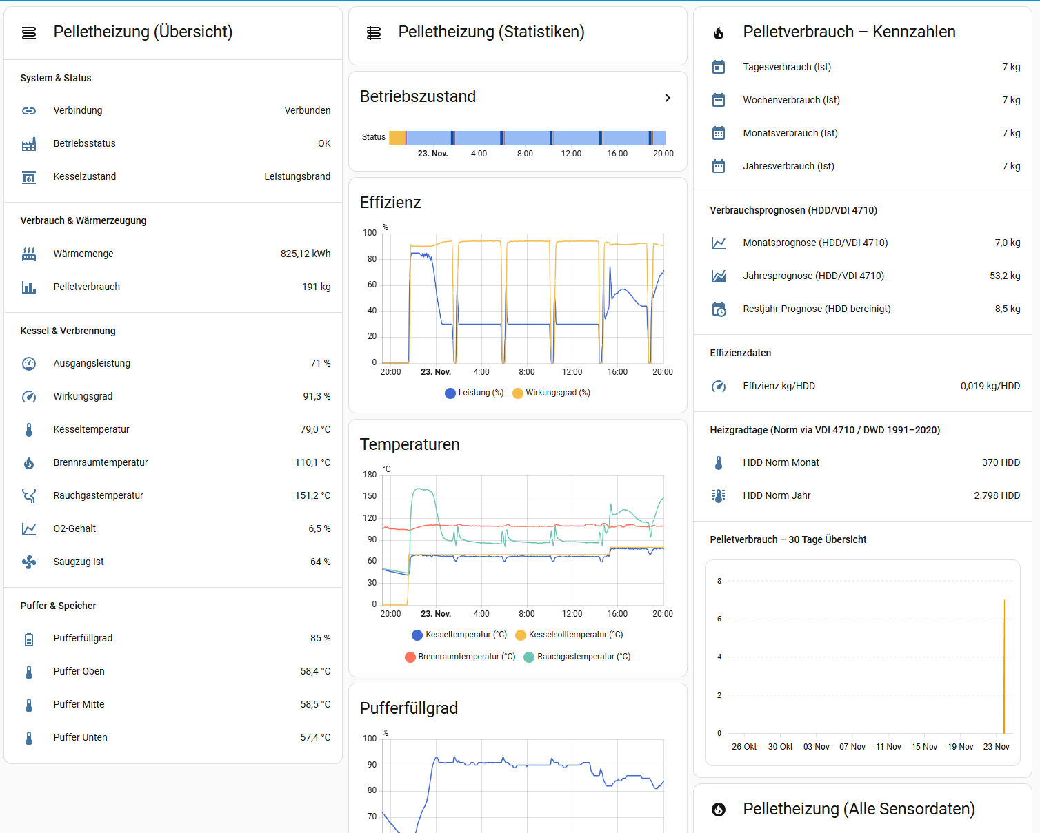

Screenshots
Device Overview:
Custom Dashboard with Pellet Consumption Forecast:

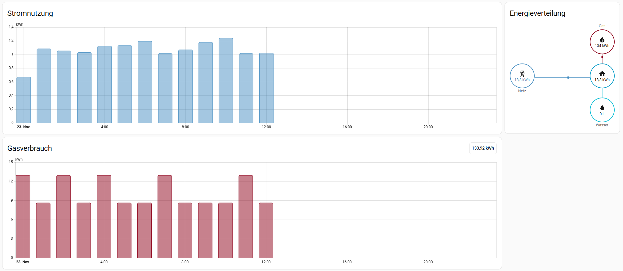

Energy Dashboard Integration:
The integration automatically creates a Heat Output sensor compatible with Home Assistant’s Energy Dashboard. The calculation uses:
Heat (kWh) = Pellets (kg) × Energy Content (kWh/kg) × Efficiency (%)
Both values are fully customizable in the integration options!

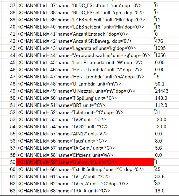

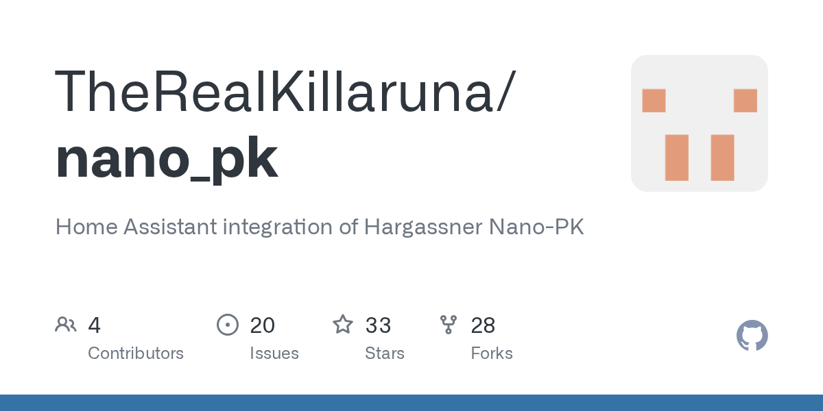

Here is the information how to extract the date with a sdcard from your heater:
Home Assistant integration of Hargassner Nano-PK
After that, you need to adjust your individuelly firmware.
Anderl78 made a describtion how to create “dummies” for data without a definition:
opened 03:00PM - 02 Sep 24 UTC
Hello!
I think I figured something out. I compared the heater's TELNET output… with the number of expected values according to <DAQPRJ> (from SD-Card). It happens (at least for me) that two additional values are transferred via TELNET, (expected by the system = 127 vs 129) - and that's why it crashes. That's why I added two (analog) dummies at the end of the msgformat - Channel 119 and 120. If this is the correct position for the dummies is questionable. Please heck this and report it here.
Interesting at this point: The length of the messages seems to be quite different, see the pull request from @apaqd (which, however, did not work for me due to its different length. I could imagine that this is due to different versions of the heater?!
Here is the working msgformat (at least for me for my NANO PK 25) with inserted dummys:
`"<DAQPRJ><ANALOG><CHANNEL id='0' name='ZK' dop='0'/><CHANNEL id='1' name='O2' unit='%'/><CHANNEL id='2' name='O2soll' unit='%'/><CHANNEL id='3' name='TK' unit='°C'/><CHANNEL id='4' name='TKsoll' unit='°C'/><CHANNEL id='5' name='TRL' unit='°C'/><CHANNEL id='6' name='TRLsoll' unit='°C' dop='0'/><CHANNEL id='7' name='Spreizung' unit='°C'/><CHANNEL id='8' name='TRG' unit='°C'/><CHANNEL id='9' name='SZist' unit='%' dop='0'/><CHANNEL id='10' name='SZsoll' unit='%'/><CHANNEL id='11' name='TPo' unit='°C'/><CHANNEL id='12' name='TPm' unit='°C'/><CHANNEL id='13' name='TPu' unit='°C'/><CHANNEL id='14' name='Puff Füllgrad' unit='%' dop='0'/><CHANNEL id='15' name='Puffer_soll oben' unit='°C' dop='0'/><CHANNEL id='16' name='Puffer_soll unten' unit='°C' dop='0'/><CHANNEL id='17' name='PuffZustand' dop='0'/><CHANNEL id='18' name='Max Anf Kessel' dop='0'/><CHANNEL id='19' name='TFW' unit='°C' dop='0'/><CHANNEL id='20' name='Leistung' unit='%' dop='0'/><CHANNEL id='21' name='ESsoll' unit='%'/><CHANNEL id='22' name='min.Leist.TRG' unit='%'/><CHANNEL id='23' name='max.Leist.TRG' unit='%'/><CHANNEL id='24' name='max.Leist.Fuell' unit='%'/><CHANNEL id='25' name='max.Leist.TPO' unit='%'/><CHANNEL id='26' name='ESRegler' unit='%' dop='0'/><CHANNEL id='27' name='Regler K'/><CHANNEL id='28' name='KeBrstScale' unit='%' dop='0'/><CHANNEL id='29' name='Programm' dop='0'/><CHANNEL id='30' name='Störungs Nr' dop='0'/><CHANNEL id='31' name='Max Anf ZenPuf' unit='°C' dop='0'/><CHANNEL id='32' name='I Es' unit='mA' dop='0'/><CHANNEL id='33' name='I Ra' unit='mA' dop='0'/><CHANNEL id='34' name='I Aa' unit='mA' dop='0'/><CHANNEL id='35' name='I Sr' unit='mA' dop='0'/><CHANNEL id='36' name='I Rein' unit='mA' dop='0'/><CHANNEL id='37' name='BLDC_ES ist' unit='rpm' dop='0'/><CHANNEL id='38' name='BLDC_ES soll' unit='rpm' dop='0'/><CHANNEL id='39' name='LZ ES seit Füll.' unit='Min' dop='0'/><CHANNEL id='40' name='LZ ES seit Ent.' unit='Min' dop='0'/><CHANNEL id='41' name='Anzahl Entasch.' dop='0'/><CHANNEL id='42' name='Anzahl SR Beweg.' dop='0'/><CHANNEL id='43' name='Lagerstand' unit='kg' dop='0'/><CHANNEL id='44' name='Verbrauchszähler' unit='kg' dop='0'/><CHANNEL id='45' name='Heiz P Lambda' unit='W' dop='2'/><CHANNEL id='46' name='Heiz U Lambda' unit='V' dop='2'/><CHANNEL id='47' name='Heiz I Lambda' unit='mA' dop='0'/><CHANNEL id='48' name='U_Lambda' unit='mV'/><CHANNEL id='49' name='U Netzteil' unit='mV' dop='0'/><CHANNEL id='50' name='T Spülung' unit='°C'/><CHANNEL id='51' name='BRT' unit='°C'/><CHANNEL id='52' name='Tplat' unit='°C' dop='0'/><CHANNEL id='53' name='TVG' unit='°C'/><CHANNEL id='54' name='TVG2' unit='°C'/><CHANNEL id='55' name='AIN17' unit='V'/><CHANNEL id='56' name='Taus' unit='°C'/><CHANNEL id='57' name='TA Gem.' unit='°C'/><CHANNEL id='58' name='ExtHK Solltmp.' unit='°C' dop='0'/><CHANNEL id='59' name='TVL_A' unit='°C'/><CHANNEL id='60' name='TVLs_A' unit='°C' dop='0'/><CHANNEL id='61' name='TRA_A' unit='°C'/><CHANNEL id='62' name='TRs_A' unit='°C'/><CHANNEL id='63' name='HKZustand_A' dop='0'/><CHANNEL id='64' name='FRA Zustand' dop='0'/><CHANNEL id='65' name='TVL_1' unit='°C'/><CHANNEL id='66' name='TVLs_1' unit='°C' dop='0'/><CHANNEL id='67' name='TRA_1' unit='°C'/><CHANNEL id='68' name='TRs_1' unit='°C'/><CHANNEL id='69' name='HKZustand_1' dop='0'/><CHANNEL id='70' name='FR1 Zustand' dop='0'/><CHANNEL id='71' name='TVL_2' unit='°C'/><CHANNEL id='72' name='TVLs_2' unit='°C' dop='0'/><CHANNEL id='73' name='TRA_2' unit='°C'/><CHANNEL id='74' name='TRs_2' unit='°C'/><CHANNEL id='75' name='HKZustand_2' dop='0'/><CHANNEL id='76' name='FR2 Zustand' dop='0'/><CHANNEL id='77' name='TVL_B' unit='°C'/><CHANNEL id='78' name='TVLs_B' unit='°C' dop='0'/><CHANNEL id='79' name='TRA_B' unit='°C'/><CHANNEL id='80' name='TRs_B' unit='°C'/><CHANNEL id='81' name='HKZustand_B' dop='0'/><CHANNEL id='82' name='FRB Zustand' dop='0'/><CHANNEL id='83' name='TBA' unit='°C'/><CHANNEL id='84' name='TBs_A' unit='°C' dop='0'/><CHANNEL id='85' name='TB1' unit='°C'/><CHANNEL id='86' name='TBs_1' unit='°C' dop='0'/><CHANNEL id='87' name='BoiZustand_1' dop='0'/><CHANNEL id='88' name='TBB' unit='°C'/><CHANNEL id='89' name='TBs_B' unit='°C' dop='0'/><CHANNEL id='90' name='HKR Anf' unit='°C'/><CHANNEL id='91' name='Anf. HKR0' unit='°C' dop='0'/><CHANNEL id='92' name='Anf. HKR1' unit='°C' dop='0'/><CHANNEL id='93' name='Anf. HKR2' unit='°C' dop='0'/><CHANNEL id='94' name='Anf. HKR3' unit='°C' dop='0'/><CHANNEL id='95' name='Anf. HKR4' unit='°C' dop='0'/><CHANNEL id='96' name='Anf. HKR5' unit='°C' dop='0'/><CHANNEL id='97' name='Anf. HKR6' unit='°C' dop='0'/><CHANNEL id='98' name='Anf. HKR7' unit='°C' dop='0'/><CHANNEL id='99' name='Anf. HKR8' unit='°C' dop='0'/><CHANNEL id='100' name='Anf. HKR9' unit='°C' dop='0'/><CHANNEL id='101' name='Anf. HKR10' unit='°C' dop='0'/><CHANNEL id='102' name='Anf. HKR11' unit='°C' dop='0'/><CHANNEL id='103' name='Anf. HKR12' unit='°C' dop='0'/><CHANNEL id='104' name='Anf. HKR13' unit='°C' dop='0'/><CHANNEL id='105' name='Anf. HKR14' unit='°C' dop='0'/><CHANNEL id='106' name='Anf. HKR15' unit='°C' dop='0'/><CHANNEL id='107' name='DiffR3TWq' unit='°C'/><CHANNEL id='108' name='DiffR3 K1' dop='0'/><CHANNEL id='109' name='DiffR3 K2' dop='0'/><CHANNEL id='110' name='DiffR3TDiff1' unit='°C'/><CHANNEL id='111' name='DiffR3TDiff2' unit='°C'/><CHANNEL id='112' name='DiffR3 P1' unit='%' dop='0'/><CHANNEL id='113' name='DiffR3 P2' unit='%' dop='0'/><CHANNEL id='114' name='DiffR3 P3' unit='%' dop='0'/><CHANNEL id='115' name='DiffR3 WMZ_Ges' unit='kWh'/><CHANNEL id='116' name='DiffR3 WMZ_Tag' unit='kWh'/><CHANNEL id='117' name='DiffR3 WMZ_Moment' unit='kW'/><CHANNEL id='118' name='Wasserdruck' unit='bar' dop='2'/><CHANNEL id='119' name='Dummy' unit='bar' dop='2'/><CHANNEL id='120' name='Dummy2' unit='bar' dop='2'/></ANALOG><DIGITAL><CHANNEL id='0' bit='0' name='Störung'/><CHANNEL id='0' bit='1' name='Stb'/><CHANNEL id='0' bit='2' name='Fuellstand'/><CHANNEL id='0' bit='3' name='RLP/PuffP'/><CHANNEL id='0' bit='4' name='RLm_auf'/><CHANNEL id='0' bit='5' name='RLm_zu'/><CHANNEL id='0' bit='10' name='WS freig.'/><CHANNEL id='0' bit='11' name='Akt. Code'/><CHANNEL id='0' bit='14' name='FW Freig.'/><CHANNEL id='0' bit='15' name='gFlP'/><CHANNEL id='0' bit='16' name='gFlM auf'/><CHANNEL id='0' bit='17' name='gFlM zu'/><CHANNEL id='0' bit='18' name='gFl2P'/><CHANNEL id='0' bit='19' name='gFl2M auf'/><CHANNEL id='0' bit='20' name='gFl2M zu'/><CHANNEL id='1' bit='0' name='L Heiz.'/><CHANNEL id='1' bit='1' name='Z Heiz.'/><CHANNEL id='1' bit='2' name='Z Geb.'/><CHANNEL id='1' bit='3' name='AA Run'/><CHANNEL id='1' bit='4' name='AA Dir'/><CHANNEL id='1' bit='5' name='ES Run'/><CHANNEL id='1' bit='6' name='ES Dir'/><CHANNEL id='1' bit='7' name='AS Saug'/><CHANNEL id='1' bit='8' name='AS RA Run'/><CHANNEL id='1' bit='9' name='AS RA Dir'/><CHANNEL id='1' bit='10' name='Rein En'/><CHANNEL id='1' bit='11' name='Rein Run'/><CHANNEL id='1' bit='12' name='Es Rein Endl'/><CHANNEL id='1' bit='13' name='sAS Anf Füll'/><CHANNEL id='2' bit='0' name='HKPA'/><CHANNEL id='2' bit='1' name='MAA'/><CHANNEL id='2' bit='2' name='MAZ'/><CHANNEL id='2' bit='3' name='HKP1'/><CHANNEL id='2' bit='4' name='M1A'/><CHANNEL id='2' bit='5' name='M1Z'/><CHANNEL id='2' bit='6' name='HKP2'/><CHANNEL id='2' bit='7' name='M2A'/><CHANNEL id='2' bit='8' name='M2Z'/><CHANNEL id='2' bit='9' name='HKP3'/><CHANNEL id='2' bit='10' name='M3A'/><CHANNEL id='2' bit='11' name='M3Z'/><CHANNEL id='2' bit='12' name='HKP4'/><CHANNEL id='2' bit='13' name='M4A'/><CHANNEL id='2' bit='14' name='M4Z'/><CHANNEL id='2' bit='15' name='HKP5'/><CHANNEL id='2' bit='16' name='M5A'/><CHANNEL id='2' bit='17' name='M5Z'/><CHANNEL id='2' bit='18' name='HKP6'/><CHANNEL id='2' bit='19' name='M6A'/><CHANNEL id='2' bit='20' name='M6Z'/><CHANNEL id='2' bit='21' name='HKPB'/><CHANNEL id='2' bit='22' name='MBA'/><CHANNEL id='2' bit='23' name='MBZ'/><CHANNEL id='3' bit='0' name='BPA'/><CHANNEL id='3' bit='1' name='BP1'/><CHANNEL id='3' bit='2' name='BP2'/><CHANNEL id='3' bit='3' name='BP3'/><CHANNEL id='3' bit='4' name='BPB'/><CHANNEL id='3' bit='5' name='BZPA'/><CHANNEL id='3' bit='6' name='BZP1'/><CHANNEL id='3' bit='7' name='BZP2'/><CHANNEL id='3' bit='8' name='BZP3'/><CHANNEL id='3' bit='9' name='BZPB'/><CHANNEL id='4' bit='0' name='Aschebox'/><CHANNEL id='4' bit='1' name='Netztrafo'/><CHANNEL id='4' bit='2' name='Netzrelais'/><CHANNEL id='4' bit='4' name='Lagerraum'/><CHANNEL id='4' bit='6' name='FLP'/><CHANNEL id='4' bit='8' name='ATW'/><CHANNEL id='4' bit='9' name='Entasch gesp.'/><CHANNEL id='4' bit='13' name='HKV'/><CHANNEL id='4' bit='14' name='Spülung Aktiv'/><CHANNEL id='4' bit='15' name='ExtHK vorh'/><CHANNEL id='4' bit='16' name='ExtHK_2 vorh'/><CHANNEL id='4' bit='17' name='ExtHK_3 vorh'/><CHANNEL id='6' bit='0' name='ExtHK Anf'/><CHANNEL id='6' bit='2' name='ExtHK_2 Anf'/><CHANNEL id='6' bit='3' name='ExtHK_3 Anf'/><CHANNEL id='6' bit='4' name='ExtHK Pumpe'/><CHANNEL id='6' bit='6' name='ExtHK_2 Pumpe'/><CHANNEL id='6' bit='7' name='ExtHK_3 Pumpe'/><CHANNEL id='6' bit='8' name='KASK1 MinLeist'/><CHANNEL id='6' bit='9' name='KASK2 MinLeist'/><CHANNEL id='6' bit='10' name='KASK3 MinLeist'/><CHANNEL id='6' bit='11' name='KASK4 MinLeist'/><CHANNEL id='6' bit='12' name='KASK1 MaxLeist'/><CHANNEL id='6' bit='13' name='KASK2 MaxLeist'/><CHANNEL id='6' bit='14' name='KASK3 MaxLeist'/><CHANNEL id='6' bit='15' name='KASK4 MaxLeist'/><CHANNEL id='6' bit='16' name='KASK1 Run'/><CHANNEL id='6' bit='17' name='KASK2 Run'/><CHANNEL id='6' bit='18' name='KASK3 Run'/><CHANNEL id='6' bit='19' name='KASK4 Run'/><CHANNEL id='6' bit='20' name='KASK1 OK'/><CHANNEL id='6' bit='21' name='KASK2 OK'/><CHANNEL id='6' bit='22' name='KASK3 OK'/><CHANNEL id='6' bit='23' name='KASK4 OK'/><CHANNEL id='6' bit='24' name='Kask KWK Out'/><CHANNEL id='6' bit='25' name='Kask FW Out'/><CHANNEL id='6' bit='26' name='KASK KWK OK'/><CHANNEL id='6' bit='27' name='KASK FW OK'/><CHANNEL id='7' bit='0' name='DReg P2'/><CHANNEL id='7' bit='1' name='DReg P3'/><CHANNEL id='7' bit='2' name='DReg Mi auf'/><CHANNEL id='7' bit='3' name='DReg Mi zu'/><CHANNEL id='7' bit='5' name='DReg2 P2'/><CHANNEL id='7' bit='6' name='DReg2 Mi auf'/><CHANNEL id='7' bit='7' name='DReg2 Mi zu'/><CHANNEL id='7' bit='9' name='DReg3 P2'/><CHANNEL id='7' bit='10' name='DReg3 P3'/><CHANNEL id='7' bit='11' name='DReg3 Mi auf'/><CHANNEL id='7' bit='12' name='DReg3 Mi zu'/></DIGITAL></DAQPRJ>"`
**One more thing:**
Please edit your hargassner.py and add following (new) line 176:
`self._errorLog += f"HargassnerBridge.async_update(): Unexpected message length. Expected: {self._expectedMsgLength}, Actual: {len(msg)}\n"`
it should look like:
async def async_update(self):
if self._connectionOK:
try:
msgReceived = False
data = await asyncio.wait_for(self._reader.read(64*1024), timeout=BRIDGE_TIMEOUT) # read up to 64k
lines = data.decode().strip().split("\n")
for l in reversed(lines):
msg = l.split()[1:] # remove first field "pm"
if len(msg) != self._expectedMsgLength:
continue
for param in self._paramData.values():
param.initializeFromMessage(msg)
self._latestUpdate = datetime.now()
msgReceived = True
self._missedMsgs = 0
break
If it doesn't work, an error is reported in the HomeAssistant protocol, which shows the expected value according to msgformat and the actual value (from TELNET). It would be helpful if we basically found out this value together with the specific model of the heater. I will also send a [pull request](https://github.com/TheRealKillaruna/nano_pk/pull/35) for this.
A dummy looks like: <CHANNEL id='59' name='Dummy 1' unit='°C'/>
Here ist an example of my excel:
Maybe it will help you to get along
Lieben Gruß aus Tirol
Tommy
