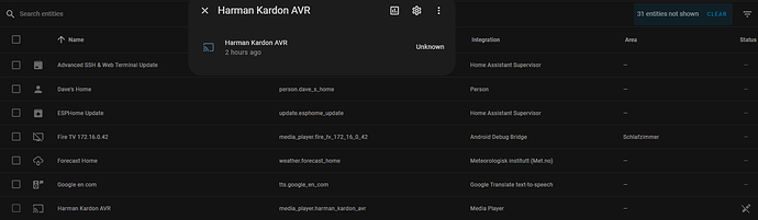

Yep. As I said the entity exists and I’m able to change the state manually but the state get’s automatically reset to unknown again.
Here is a screenshot of the entity:
Here is a screenshot of the developer options state:

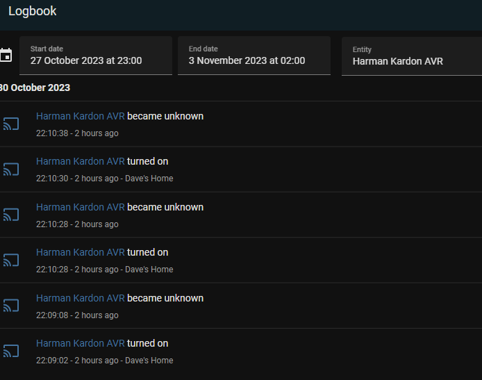

The logs only show the following. The on state was triggered via the web gui from myself and it was reset within settings:
That’s the logbook it only shows status updates. Look under settings > system >logs. If you don’t see anything we can still turn on debug logging but I bet if it’s failing to collect status you’ll see something without debug.
