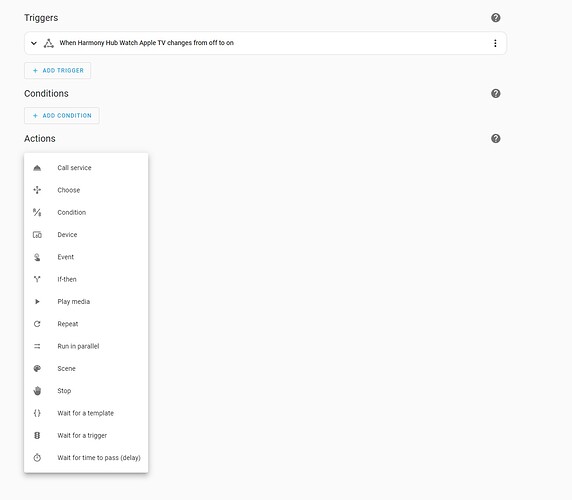

Dear Gurus request your help with the below automation
Problem Statement -My harmony hub is inside a cabinet far from the JVC projector.
I installed the JVC Projector IP Control component, which is now available as a remote.
So when I run a harmony activity, say Play Apple TV ( Denon +Apple TV), I also want the projector to turn on and turn off the projector when the activity is turned off. How do I accomplish this?
Trigger(s):
Actions:
@tom_l Thanks a bunch, but I am unable to select the remote (projector)
You should be able to use HDMI CEC function between source and projector to control the projector power on and off
You may need to turn this on in all the devices menus
Thank you @tmjpugh ,surprisingly the JVC RS3100 does not have the HDMI-CEC option. Hence i added the JVC as a remote using the HACS repo.
Call service → remote/send_command
Thank you so much @tom_l
