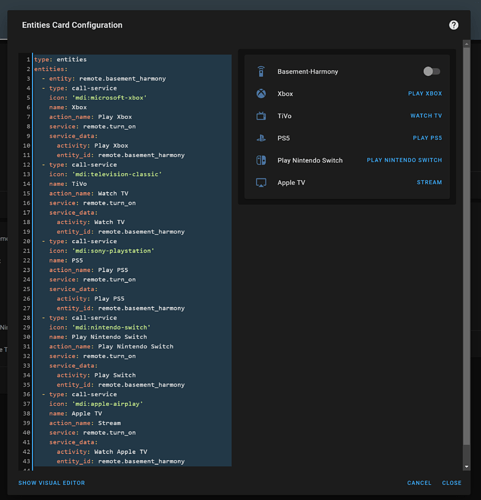

Hi Jebus2504 i had same issue (i am new too). All I wanted was a simple card that let me turn activities on and off. I have no intention of using hass as a remote. I have a perfectly good remote for that. This is what i came up with:
I hope this also helps someone get started easily with harmony remote.
This was done with this code:

(use the code editor once you have added the card - like this)
