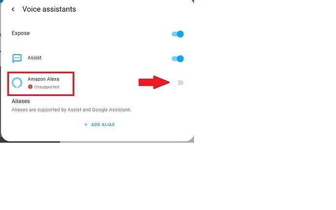

Harmony Hubs show unsupported when trying to expose entities to alexa
I have a new install of home assistant and alexa voice control for harmony hubs worked until about 3 months ago. Suddenly voice control stopped and when i looked at the expose to voice assistant settings alexa now says unsupported on all 3 of my hubs. i reset all hubs, remote access in HA and the HA skill in alexa. Other things in HA can still be controlled by alexa but not the harmony hubs. anyone else experience this or know of a fix?
Harmony hubs have always shown up as remotes in Home assistant and remotes have never been supported by Alexa.
But quite a while ago, Activities where exposed as switches. The switches are no longer there, they were removed over I year ago I guess. So what was it exactly that was exposed? If it was the activity switches, you can recreate them using helpers.
