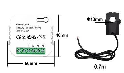

Has anybody managed to get this device to work in HA?
I bought this Energy meter sensor, it works amanzingly well on the tuya app. However, through the tuya integration to HA, it shows up but there’s no entities.
Here’s the device: Avatto-Tuya WiFi Energy Meter Controller, Energy Meter, Current KWh, Estatísticas Eletricidade Energia, Dispositivo de Monitoramento para Alexa, Google Home, 80A - AliExpress 44
I don’t know if I can post links in here, I apologize in advance if it is forbidden.
It is likely since that seems to be the local Portuguese Ali you’re posting and the link for some reason is not available in US. Go figure :wink:
Whenever I try to change the country to US, I get the same error… I don’t know if a picture might help, but there it goes
yes i got it work.
just follow this step
. when added device select avatto energy meter in local tuya. if avatto not available select gateway and use gateway ip address. on sub device id enter avatto mac address from tuya app
