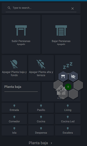

Buenas tardes, tenia funcionando el menu y post actualizacion del CORE me deja de andar. A alguien le paso?
Hambiente:
Home Assistant 2023.8.1
Supervisor 2023.08.1
Operating System 10.4
Frontend 20230802.0 - latest
Codigo:
type: custom:button-card
icon: mdi:home-assistant
tap_action:
action: call-service
service: honeycomb
service_data:
active: true
buttons:
- icon: mdi:window-shutter-open
name: Subir persianas
tap_action:
service: script.subir_persiana_planta_baja
- icon: mdi:lightbulb-group-off
tap_action:
service: script.apagar_luces_planta_baja
aspect_ratio: 4/2
styles:
card:
- height: 100%
grid:
- position: relative
custom_fields:
notification:
- background-color: |
if (states[‘counter.luces_planta_baja’].state == 0)
return “green”;
return “red”;
- border-radius: 50%
- position: absolute
- left: 60%
- top: 0%
- height: 40px
- width: 40px
- font-size: 15px
- line-height: 40px
custom_fields:
notification: |
[[[ return Math.floor(states[‘counter.luces_planta_baja’].state) ]]]
state:
  • value: 1
    styles:
    card:
    - box shadow: 0px 0px 20px 3px green
    icon:
    - color: var(–paper-item-icon-active-color)
    name:
    - color: white
    state:
    - color: white
    label:
    - color: white
  • value: 0
    styles:
    label:
    - color: rgba(0, 0, 0, 0.0)
Efecto:
Big change in button-card 4.0.0 breaks honeycomb-menu.
Temporary workaround is to downgrade button-card in HACS to 3.5.0.
Excelente! is good:
Thanks

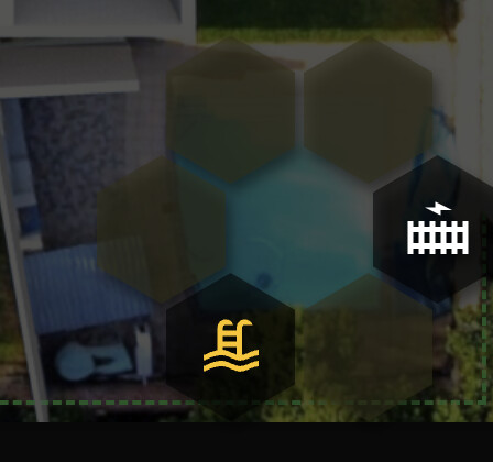

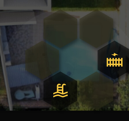

Hi there,
Thanks for the tip.
Your solution works except the 2 “Active” colors aren’t working.
    - name: Pool Menu
      type: image
      style:
        transform: translate(0,0)
        top: 77.5%
        left: 50%
        width: 50%
        height: 22%
      image: /local/1x1-00000000.png
      tap_action:
        service: honeycomb
        service_data:
          autoclose: false
          animation_speed: 10
          active: true
          buttons:
            - show: false
            - show: false
            - icon: mdi:fence-electric
              entity: switch.electric_fence
              tap_action: more-info
            - show: false
            - icon: mdi:pool
              entity: switch.pool_pump
              active: true
            - show: false
      hold_action: none

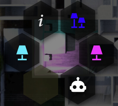

    - name: Main Bedroom Menu
      type: image
      style:
        top: 53.5%
        left: 16%
        width: 18%
        height: 11.5%
      tap_action:
        service: honeycomb
        service_data:
          autoclose: false
          animation_speed: 10
          buttons:
            - icon: mdi:information-variant
              tap_action:
                service: honeycomb
                service_data:
                  autoclose: false
                  animation_speed: 10
                  active: true
                  buttons:
                    - entity: media_player.bedroom_speaker
                    - entity: sensor.bedroom_temperature
                    - entity: sensor.bedroom_humidity
                    - entity: sensor.bedroom_pressure
                    - icon: mdi:floor-plan
                      tap_action:
                        action: navigate
                        navigation_path: /lovelace/badroom
                      hold_action:
                        action: more-info
            - icon: mdi:lamps
              entity: light.bed_lamps
              color: auto
              tap_action:
                action: toggle
              hold_action:
                action: more-info
            - icon: mdi:lamp
              entity: light.bed_lamp_right
              color: auto
              tap_action:
                action: toggle
              hold_action:
                action: more-info
            - icon: mdi:robot
              entity: input_boolean.bedroom_routine
              color: auto
              tap_action:
                service: honeycomb
                service_data:
                  autoclose: false
                  animation_speed: 10
                  active: true
                  buttons:
                    - icon: mdi:calendar-blank
                      color: auto
                      tap_action:
                        action: toggle
                    - icon: mdi:motion-sensor
                      entity: input_boolean.bedroom_motion_lights
                      color: auto
                      tap_action:
                        action: toggle
            - show: false
            - icon: mdi:lamp
              entity: light.bed_lamp_left
              color: auto
              tap_action:
                action: toggle
              hold_action:
                action: more-info
      hold_action: none
