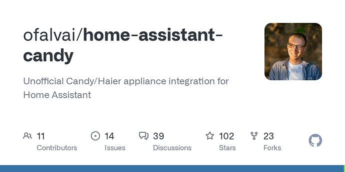

Does this help???
@anon94216691 & @ddaniel The washing machine already has WiFi.
@vreihen That repo looks tremendously interesting. I will absolutely give that a go.

If you don’t succeed in integrating this with hacs integration posted above you can do it in the way I and @anon94216691 suggested. You need a smart plug for power monitoring and one or two contact sensors and one fingerbot.
I have dumb washing machine and I made it smart with this.
I understand that you bought washing machine with wifi and you want to have it integrated in home assistant, as it is in the app. But if this doesn’t work, you can try other solutions.
