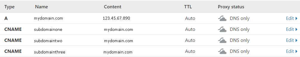

I have exactly the same issue, put all into A name, but how to put in CNAME? Sorry newb here. Could you post your clouflare screenshot (hiding your data of course)
this mine, of course I added more A for having more subdomain, but then only one is updated fron the addon
Sorry for the late replay, @Klagio
This is how my config on cloudflare looks like (in principle, of course, names and numbers are changed):
