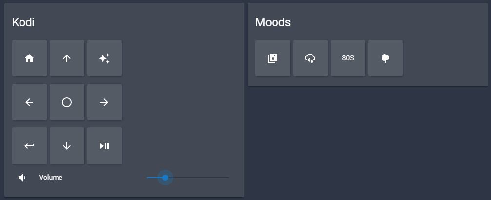

I’m doing a Kodi remote and this is what I got so far:
  • Remote control functions: Up, Down, Left, Right Select, Back, Home, Play/Pause, Slider volume
  • Party Mode (play all songs in random order)
  • Play RainyMood (music addon for white noise)
Wishlist/WIP:
  • Play a specified genre/artirst
  • Play the last unseed episode of a specified tv show
Looks very interesting. Your screenshot doesn’t look like the usual HA interface, how did you set it up?
I haven’t come very far at my end yet. Will definitely try some of your stuff!
I have my config in https://github.com/maattdiy/home-assistant-config#home-assistant-configuration
For the buttons I use the Custom UI Tiles
Do you have a repo?
