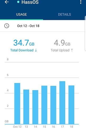

Is this normal data usage for Home Assistant or is it due to Cloud connection? I’m averaging around 5GB down / 1GB up everyday.
Are you using the speedtest component? Others have posted about data usage in the past not realizing that the speedtest component if run frequently can rack up some data.
My usage seems to be in the same ballpark. No cloud setup though
I am using the speedtest component. Oh heck! I never thought about that. That’s probably a lot of it right there. I’ll have to remove it for a couple of days and compare.
Thanks
