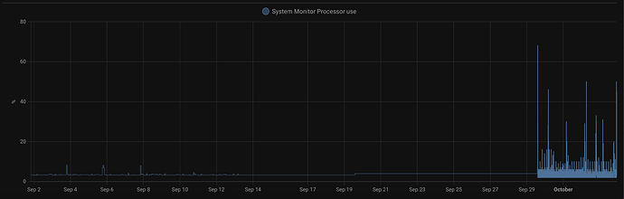

And here some screenshots on hardware usage. The server stopped working from the 13th to the 29th.
