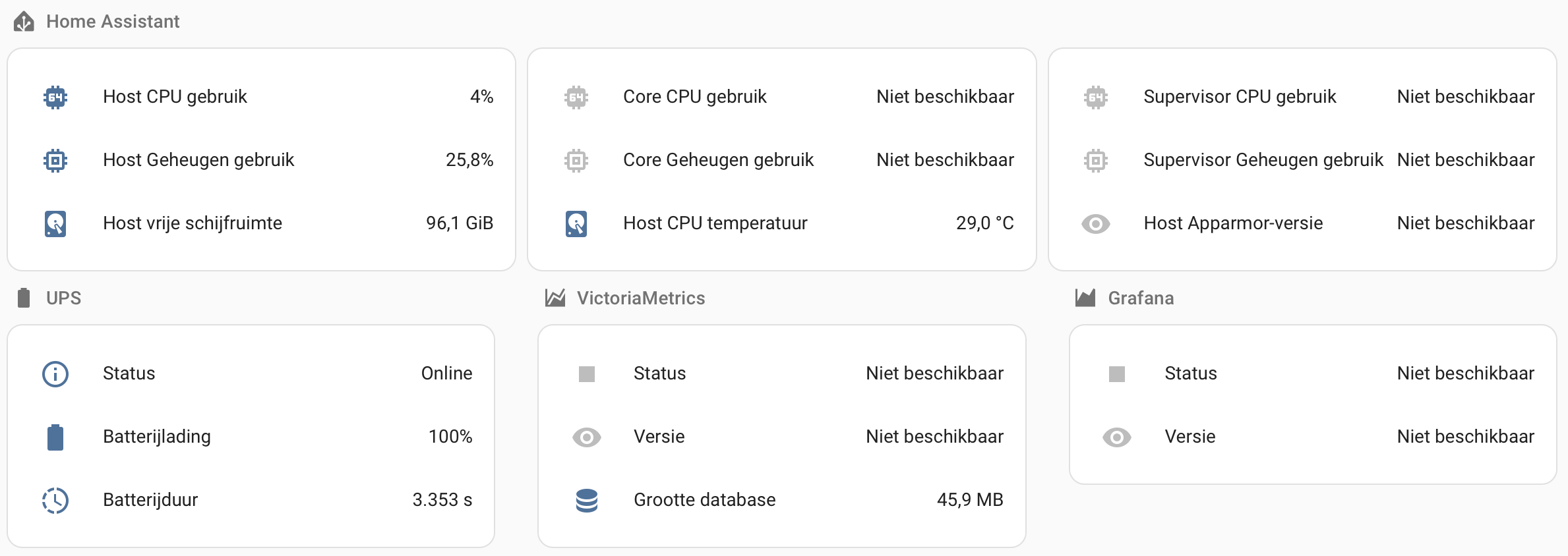

Hi there, I am experiencing the same issue. Everything was stable until the 2025.x versions were deployed.
Currently running:
Core: 2025.1.2
Frontend: 20250109.0
Supervisor: don’t know how to get its version…

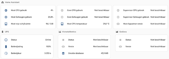

Cards show, that supervisor and all add-ons stopped working:

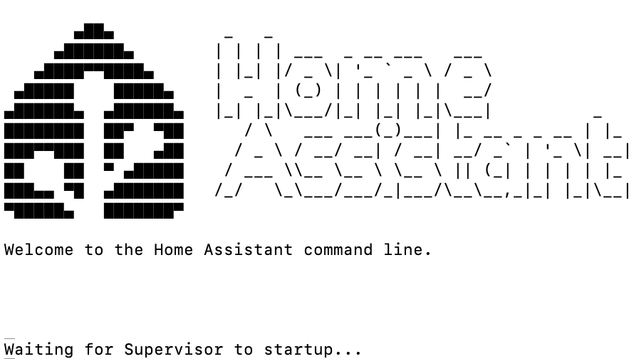

SSH login shows:

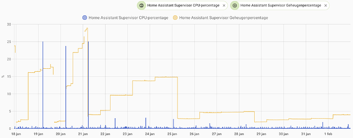

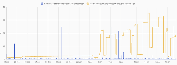

Supervisor trends show increased memory usage from beginning of the year:
What is the best way to tackle this issue? Thanks for any help to get this solved…
Regards, Joost

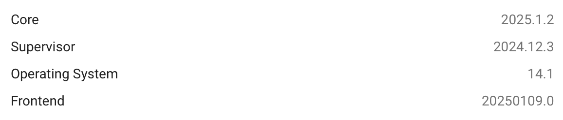

UPDATE #1: After power off / on it works again and version information is displayed:

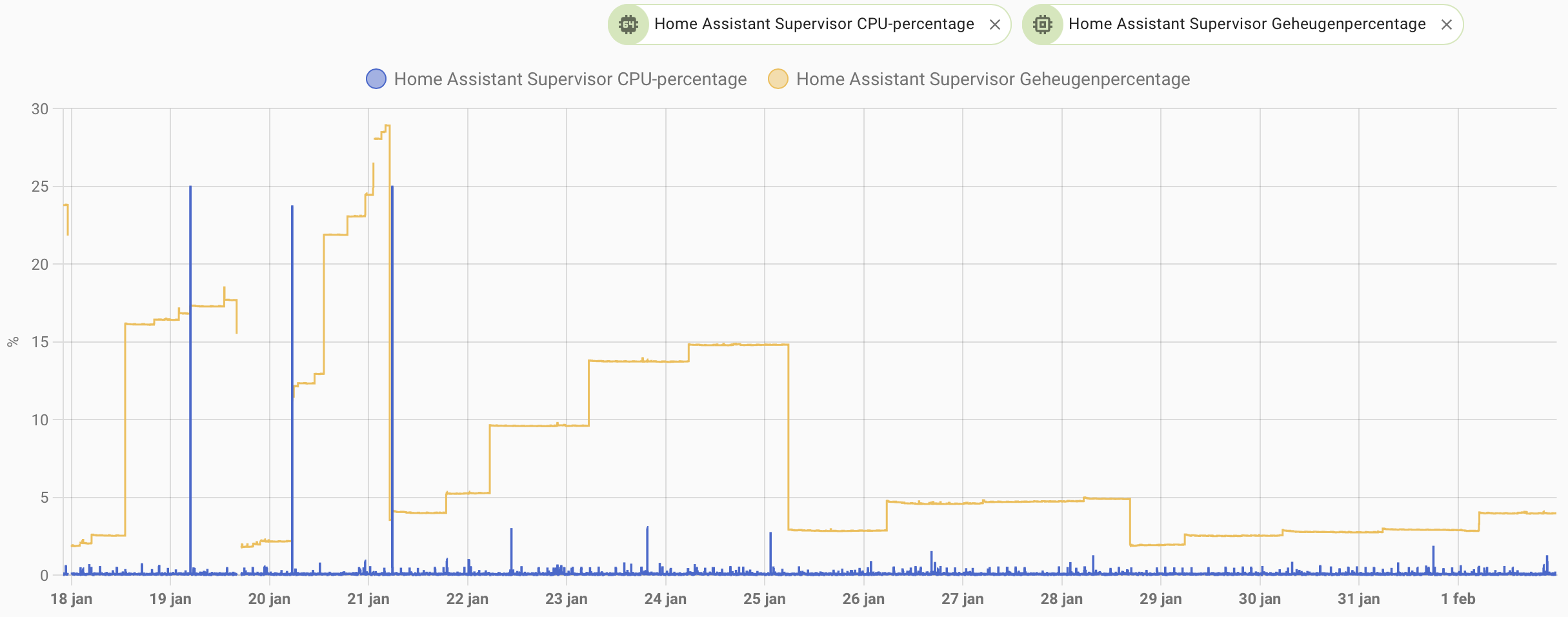

UPDATE #2: After a few more crashes, it seemed to be linked to the backups that were running. I removed all of them, except for the nightly backup using the new build in backup and HA Cloud upload. After that there were no more no more crashes. Memory usage is lower, but does still goes up each time a backup is done:
