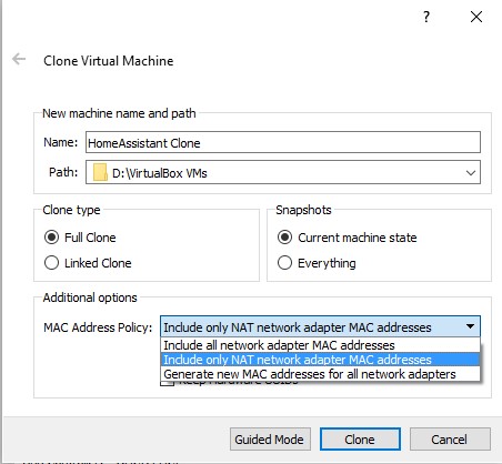

When I create the clone what do I select for MAC Address Policy,and the Additional Options âKeep Disk Namesâ and âKeep Hardware UUIDsâ

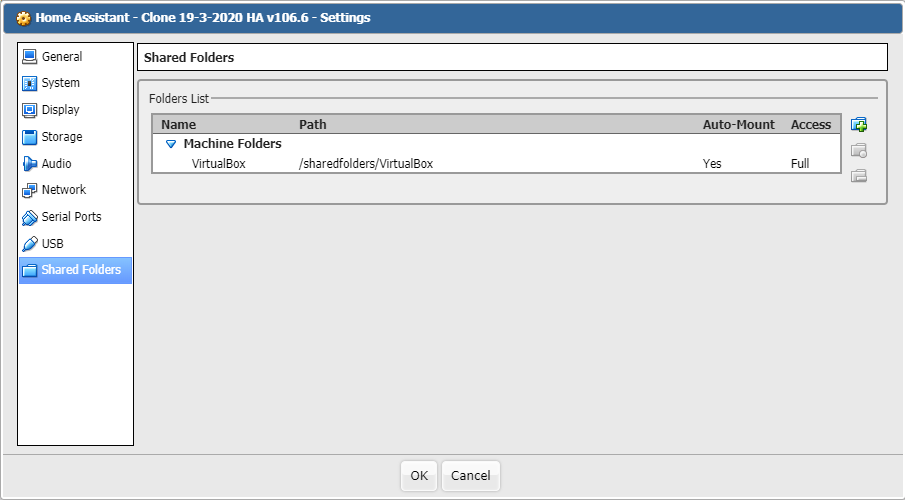

I can update Home Assistant normally. No loss of anything. Maybe you have not set a shared folder outside of the VM environment?

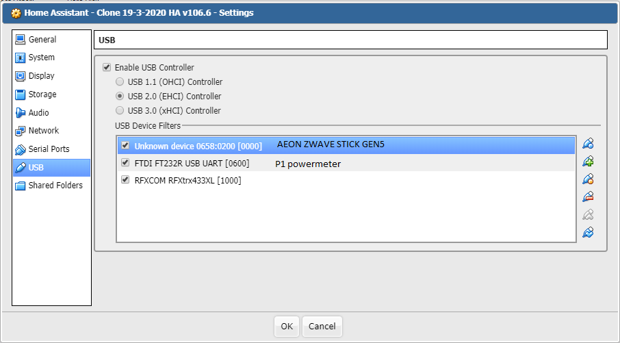

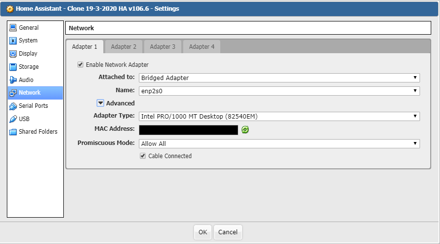

I have added screenshots to help.
Just to note:
I am running this Virtualbox plugin on OpenMediaVault 4. This is an opensource Debian NAS thing.
In it, I have created a separate network adress for home assistant.
This way the nas has a different IP than homeassistant has.

These two screens is what I see when I clone, the settings as in the screenshots.
Hope this helps.
I dont get the question about keeping disknames. But from what you wrote, It sounds like I would be saying YES to both those questions.
Hey all, revisiting this clone issue. There are a lot of settings here and iâm not sure which ones to use when cloning my hassio install on ubuntu64:
I just want to make sure I get this right when I clone my machine.
Thanks!
I would select:
include all network adapter MAC adresses.
Tick Keep Disk Names
Tick Keep Hardware UUIDs
First part (mac adresses) Virtual box asks this because it fears you will run the clone along side with the original, causing a clash in mac adress. In your case of backup (and disable autostart) this will not be an issue. This method probalby better if you have a router with MAC adress filtering i.e. so you dont have to adapt to the new mac adres.
Second halve, two lines with the ticks befor it, I have never seen those myself. But thinking along the path you just want everything to be identical to the original I would tick these.
