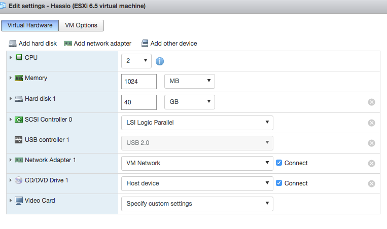

The config is
I replaced the Hard Disk 1 with a new one connected to the whatever.vmdk file generated before.
In the VM Options I changed this to EFI
and then this is what I get, sometimes it ends to the penultimate row, sometimes to the last one.
What can I check/change more?

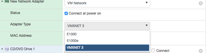

Maybe unrelated, but in vbox the image was fussy about network card emulation. I chose the most generic intel emulation and it worked.
In ESXi I can’t choose Network Adapter, the only one is VM Network, I’ve also set Passthrough, but nothing changed…
:thinking:
If you click the small triangle to the left of network adapter you get more options.
Ill check my install when I get home to let you know which one I am using.
There are these three choices.
I’ve tried with all of them, but same result.
I found that there are packages to install (even if I don’t know how to do it!), and thi is the list filtering for “netw”
“Intel PRO1000 Network Driver” should be the one installed.
Again, VBOX may not be relevant, and your problem may be completely unrelated, but FYI the emulated card that works in VBOX is Intel/PRO 1000 MT Server (8254EM).
Thanks, I’ll keep in mind and try to find other Network card to load in the VM.
